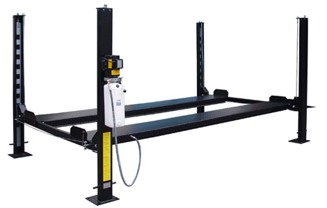

I want this :D
But, I don't have the place or the budget for that. So, if anyone has any good recommendations I'm all in. I've noticed a lot of folks built their own with wood, but I want something I can fold and store easily.

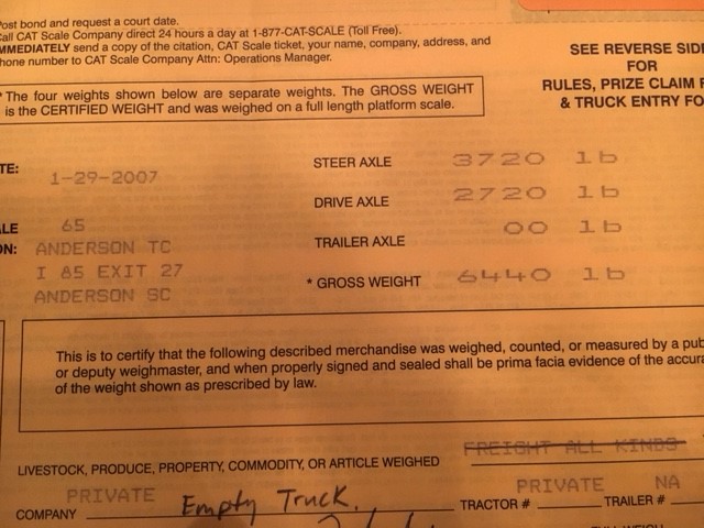

Just for numbers here is an old CAT Scale ticket that says my truck is ~ 4K lbs on front axle sitting level (3,720 lbs measured).
