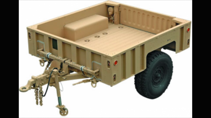

Mine is a little 14' camper I don't think weighs 2,000 lbs loaded. I could load it on top of my hummer and carry it. To bad there are bridges and trees to go under. Haha.
I really want a m1102 and a slide in monster like Leroy's.
Then when not camping it's a dump bed work trailer. They use same rim and tired as my Hummer. Maybe one day. If only I could get my wife to not like these old campers.

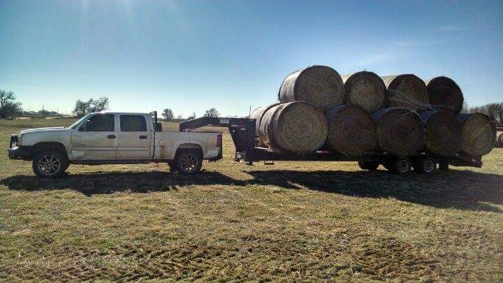

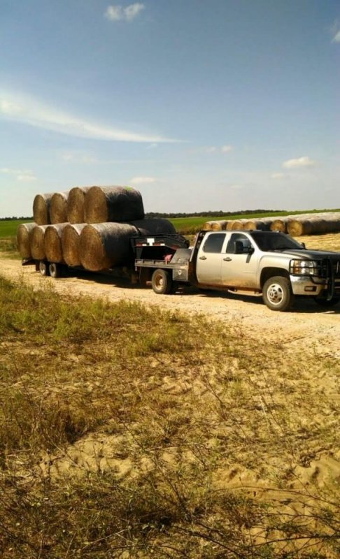

Yeah, has 3 ht3's 1 Goodyear HT, 1 Yokohama HT, one kleavar 14ply, 2 gladiator 14plys, and 2 spare gladiator 14's. Started with all geneneral 10 ply 235/80's but after buying 4 similar trailer tires and they separated in 2 years I started changing them in pairs to 235/85's but not all shops had what I needed when I needed them. As they blow I will keep going with HT3's, right now all 10 tires are only 1yr to 4mo old.
Those bales weighed 2200 each, 30 mile one way hauls on 90% gravel, 2 miles black top, and through a couple pastures.
30,800lbs of horsesh** in the making? So your about half a semi load total. Yeah, you would know quick which tires hold up. Remind me not to brake check you:wideyed:
The 31 in critter grub plus the 16 you mention is 47. My guess was 10 on truck and 3 trailer so 44. Full semi is 80,000 so around half either way.
I always guess low on weight- 21 years of marriage with almost no arguements. Always guess lighter, smaller size, and more time. :shame:
