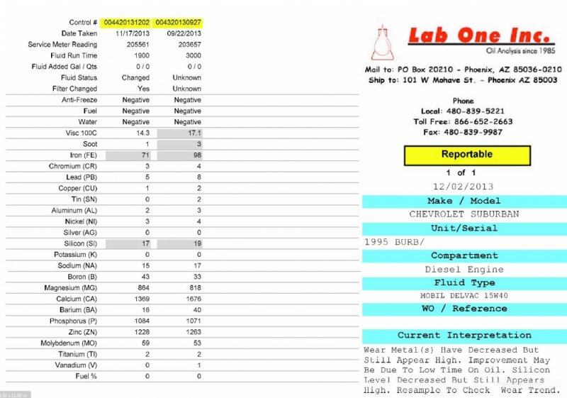

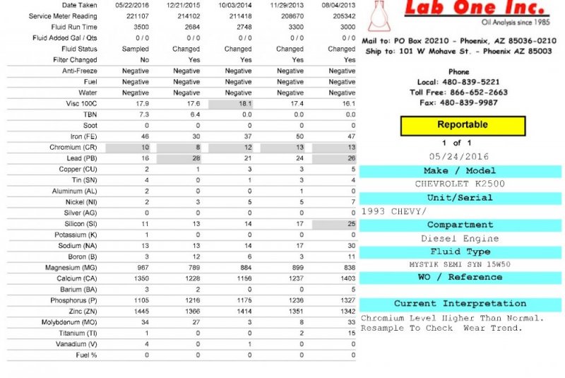

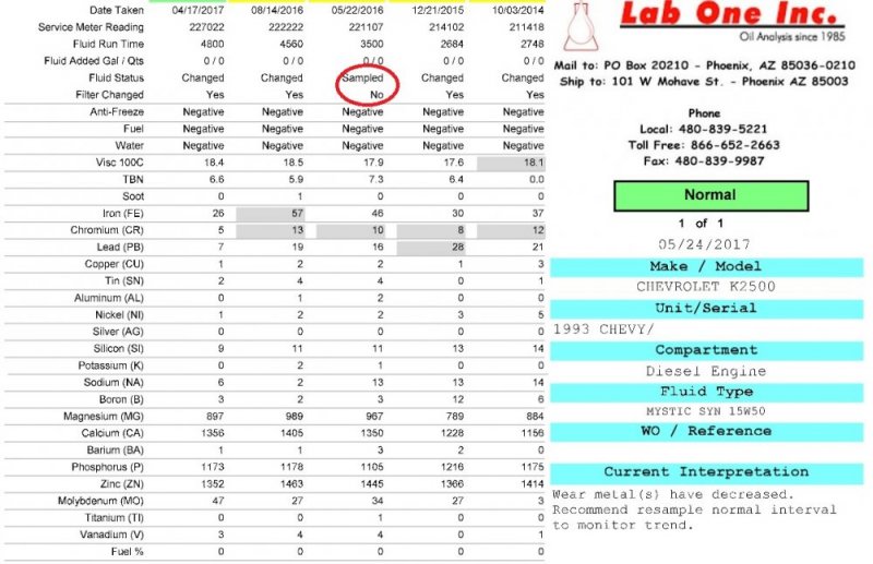

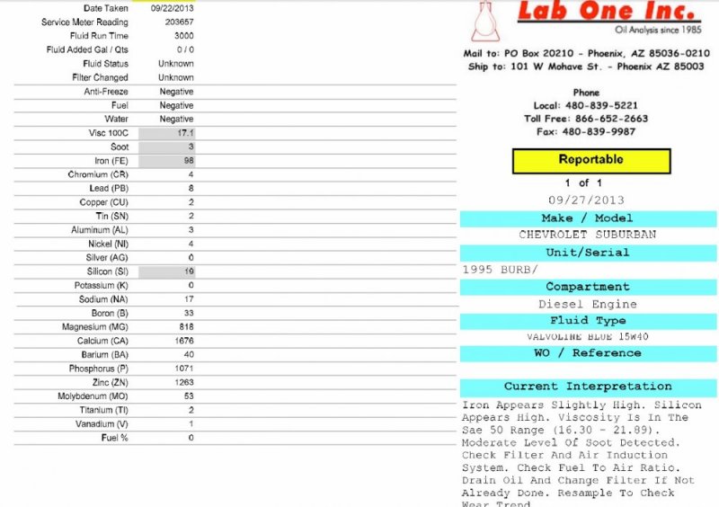

I see 6,000 miles on it through those 3 samples. Is the first one from the first test after revuild, or how many miles since the rings went in? Also the metal percentages dropped almost perfectly across the board, so it looks like thats break in.
