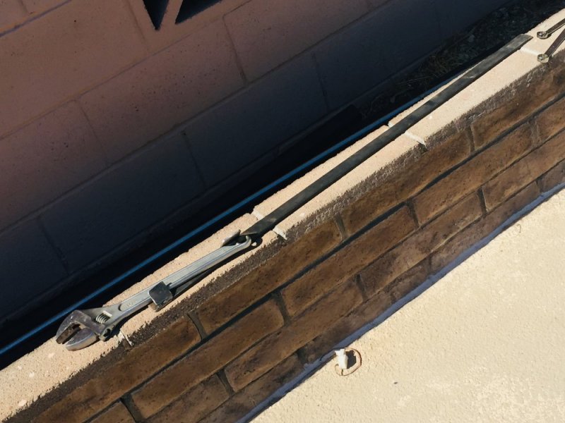

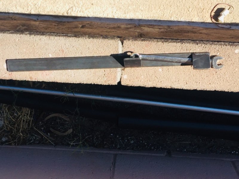

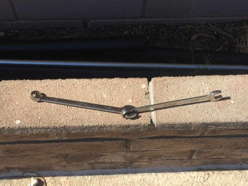

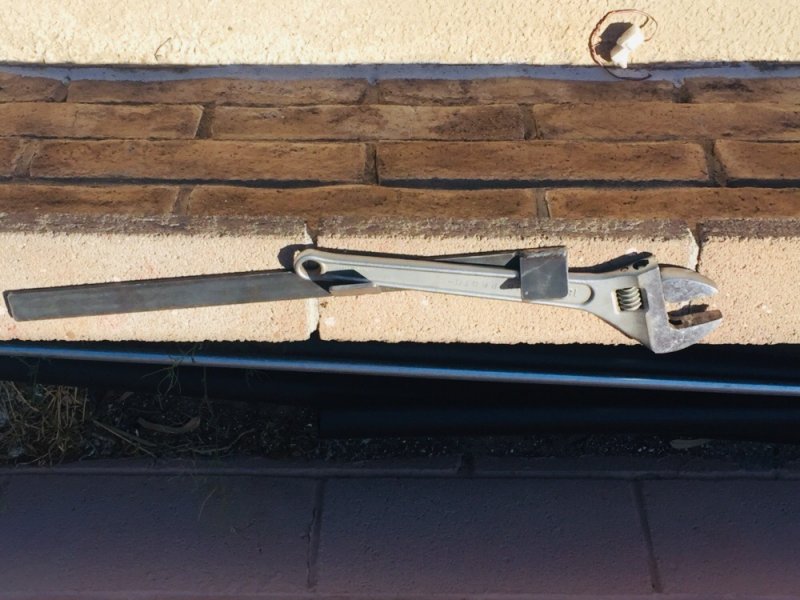

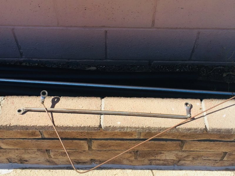

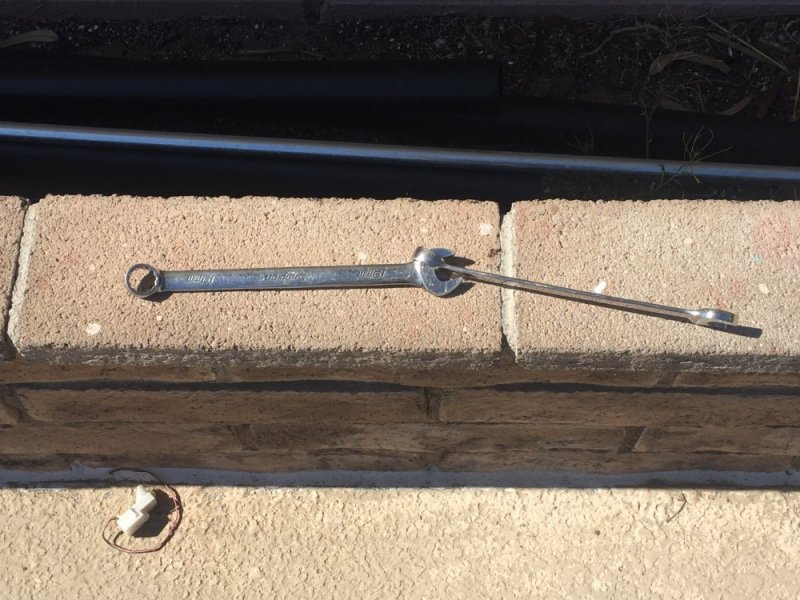

The above: most know trick of two wrenches interlocked for leverage, but it can bend open the open side and ruin wrench. Make one of these out of 1” flatbar. Couple different lengths help. These are my bigger ones for wrenches 1”-3” size. Gave away my last set of normal ones, gotta make another set. Quick wrap of tape holds it on if needed.
Also- using a piece of pipe as an extension handle- something all tool guys are taught is look for the moon shaped dents caused by pipe and warranty void. No marks ever left by these...

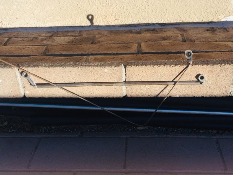

Cut up gear wrench for hard to reach places. Zoom in to see that the wrench can swivel on the rod by just drilled hole through wrench and on a pivot. Huge time/ knuckle savers.

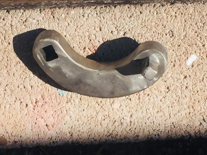

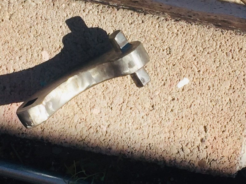

Curved thing is like an extension/crowsfoot for reaching around things like actuators. A bit more involved to make, but once you make it- lifesaver.

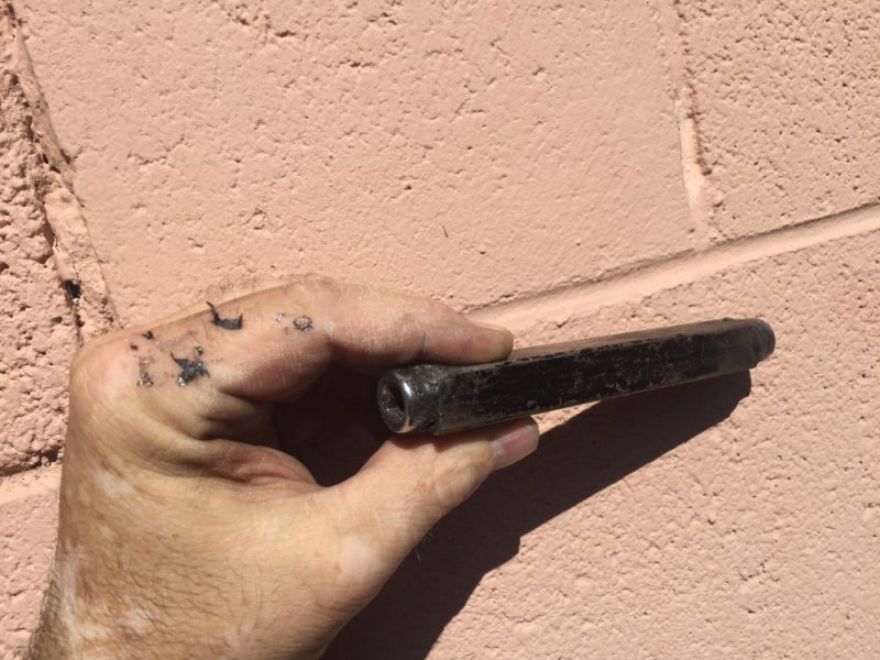

Last one is chop socket in half and weld whatever pipe handy to make it a super deep. Made this one when I was like 11 years old. Still comes in handy. The square pipe seems counter intuitive, but able to put a wrench on it actually helps sometimes too.
I know the two wrenches locked together trick but not the flat bar trick. Good deal on that and I’ll be making a few come Monday morning hopefully.
Having the half moon marks on a wrench will void the warranty every time.
A young teenage fellow that works with me used a cheater bar on his 14” aluminum Rigid pipe wrench and broke the handle. All he really needed was my 24” aluminum pipe wrench but was to lazy to get it out of the truck. He said that he was going to turn it in under warranty. I told him that they won’t honor that because it’s obvious that he used a cheater bar on it. I was right and I was taught not to use a cheater bar on a aluminum pipe wrench long ago for that very reason.
Ive welded up aluminum ones afterwards and owned a banana 36” and banana 48” steel. All Rigid. Is there any other worth buying?!? Haha.
Actually nowdays I would look at Knipex. All their stuff I used is AMAZING. If you guys never compared knipex to channel lock type pliers- you’ll be spending $ so font look until ready to blow some cash!
