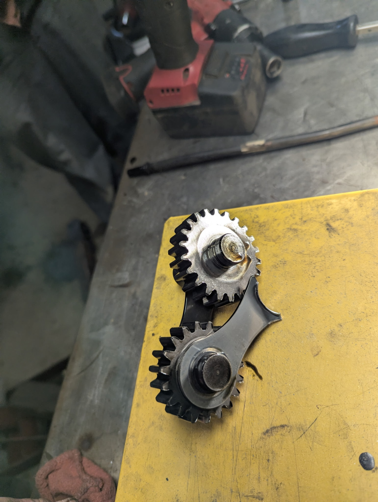

Figured I'd go ahead and post here as a warning to others.
Timekeeper set installed in a brand new P400 in 2022. 20k miles on the motor and Timekeeper set. Around Thanksgiving I noticed a knock coming from the engine, then found glitter in the oil.
Thankfully the pieces of the exploded dogbone were found and the engine is being rebuilt. This time with the standard timing chain.

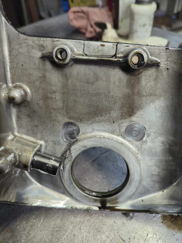

I’m convinced the axles were pinched.
The axles have to float freely, if they get pinched the axle binds ever so slightly and will sideload them into the gear. Thats what causes the axle to spin with the gear. See the rotational marks on the timing covers?
The one side could be argued it spun after the dogbone failed & thats the cause of the spin on that side. But obviously both spun.

When the water pump was replaced back in September - my mechanic said he had to use a "thicker" gasket in order for the dowels/shafts to not interface with the timing cover. So he did notice them touching the cover but perhaps it wasn't enough.
Obviously it wasn't, the directions say to grind the shafts for clearance.... those gaskets that can be purchased aren't anywhere close enough to get .050" clearance unless a person uses 8-10 of them....
