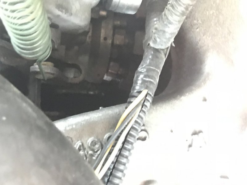

Well.....as of right now I may or may not be drag racing. Last night I was hammering the truck pretty good on back roads while I worked on optimizing the transmission tune. About half way through I developed a bit of a rough idle. Today the idle wasn’t any better, but I noticed that it ran fine above 1000rpm and didn’t seem to be down on power. Interesting. I also started to notice the smell of raw diesel.....hmmmm. I popped the hood and started looking around. Hey! What’s that shiny stuff in the valley of the engine!?
I looked further and found a leak at a line at the pump. Loose line? Cracked line? Not sure, but I guess I’m digging into it tonight. I think I have a spare set of DB2 lines lying around so even if it’s a cracked line, hopefully I’ll be back up and running.
Here’s a pic, but you can’t really see the leak. View attachment 52993

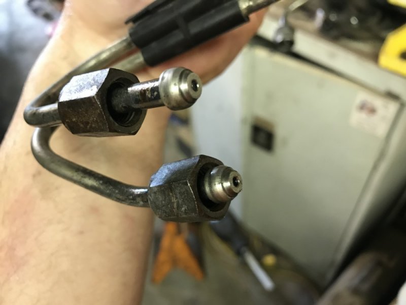

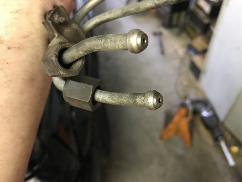

Found the leaker. It was one of the lines I could reach with the intake on, but the fitting wasn’t loose....so off came the intake. I tried loosening and retightening the line and still it leaked. This is the first time I had ever run the engine with the intake off - the exhaust from the heat riser scared the crap out of me!! I thought I had some seriously leaking intake valves until I realized what was going on.
Luckily I found a spare line set. I compared the ends and it looked like some goon (me) overtightened the fittings. Here’s the set I took off:
Here’s the set I had in stock:
They really were a lot better despite how it looks in the pic.
I wonder if that burr could be ground off of the line set and it could be re-used? I’m going to save it for just in case. Coincidentally (or rather NOT coincidentally I’m sure) I found the screw missing from the line retention bracket on that same line set a couple weeks ago. I have no idea how long it had been missing, but I’m sure it’s no coincidence.

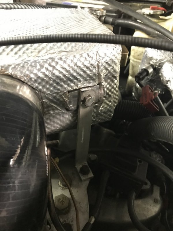

I got it back together tonight. Everything is good, but I took it for a drive and the first time I got on it the elbow blew off the intake. I forgot that last time I put this together I had to clean it really well and use hairspray as an adhesive. So I took the intercooler back apart and cleaned it and sprayed hairspray on the connections. I thought about making a brace in the past, but for some reason it seemed tricky.....tonight the solution seemed obvious. So I found a piece of aluminum flat stock and made a quick bracket. This should stop further blow-outs by holding it down to the upper intake.
