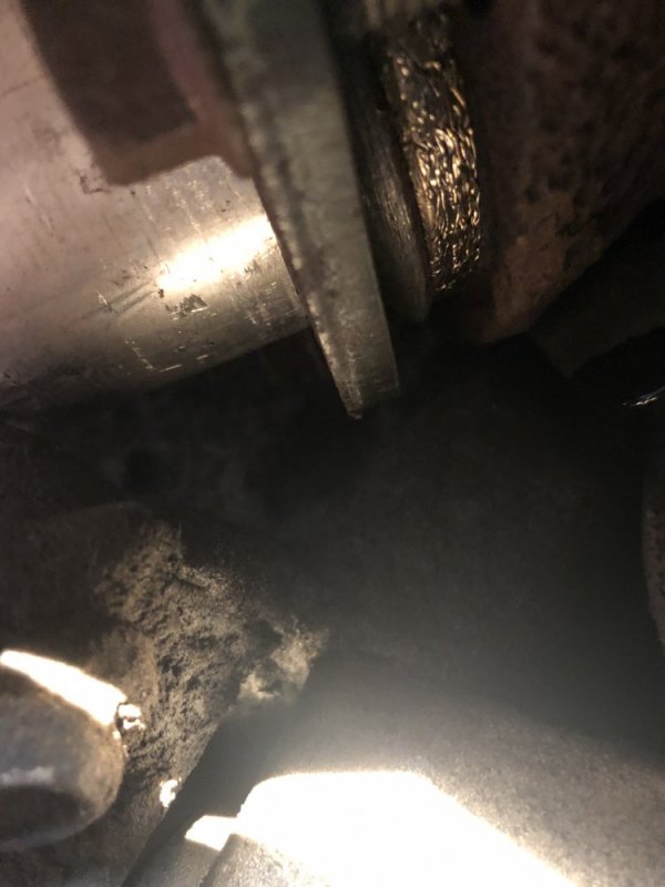

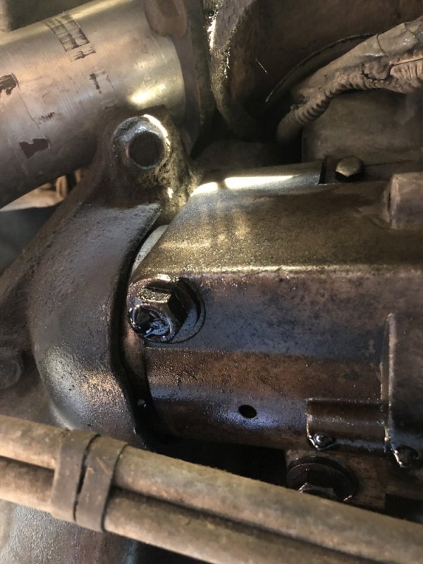

I also keep 2 rebuilts on hand. Used to be 3 til we had the 98 Suburban starter fiasco. Broke 2 housings installing a starter. Never had an issue installing a starter before or since. Never heard of anybody ever cracking the housing while torquing the bolts. I still do not have a clue what went on there
If it cracked between the bolt holes, it is usually a tiny pebble gets on there. When you tighten it down the little uneven surfaces causes the aluminum to try to flex and ka-snap goes the housing (and usually temper too). Not that I ever made that mistake but uhh dont ask how i can answer that.
