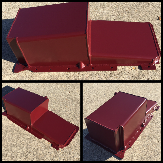

Am happy with the P-400 despite running into a few bumps. (Don't ask as I am not ready to tell ;) ) Overall, the P-400 is more quiet than the 506 block and its sweet spot is around 1,800 RPM's with the 4" exhaust and FTE resonator.
One thing to remember is that with the P-400, it also *must* come with the custom oil pan (Yes, even for a C truck) which will replace the one that comes from AMG. Speaking of pan, I am about to go on my 3'rd pan. Recommend getting one that looks like it was plasma welded (like Leroy's) as I had issues with ones that looked like they were stick welded.

Stick welded leaked or was there other damage too?
On pan #1, it was definitely a leak at a weld joint (pan to the flange that attached to the girdle).
Do not know about pan #2 yet, but there is a leak adjacent the oil filter housing and I will need to drop the driveshaft to get at it to see what is going on. Even if pan #2 is Ok, it is coming off anyway and am putting Leroy's pan on.
Do you have the pan already? If not give about a 4 week lead time.
Here is pan #3; does this look familiar? :D
And by the way, pan #2 was *not* yours (it was from the same source as pan #1 replaced under warrantee) ;)
Man that is a seriously beefy pan!
I don't know what surprises me more, that there's more than one place to buy a P400 pan or that someone could screw it up that bad. I'm sorry to hear you've had that much trouble, that would be seriously infuriating, that would not be a simple fix.
