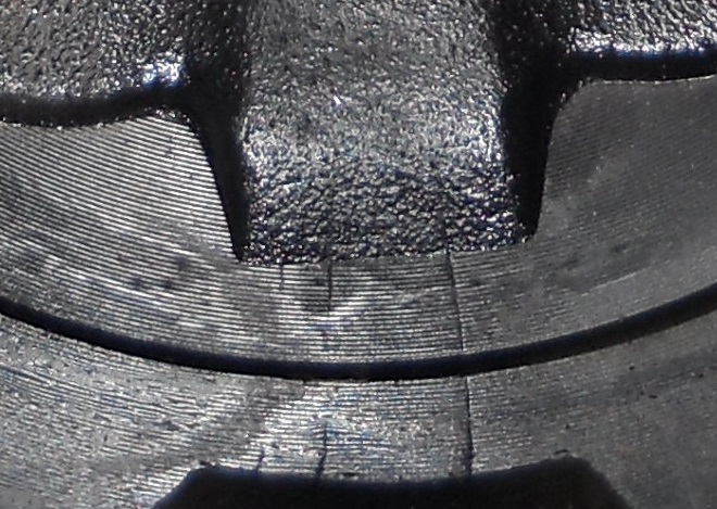

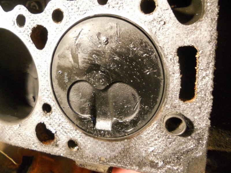

Of course someone uses too much and pistons crack.
Habit forming use example of too much heat. Melted pistons.

Most of those warning labels say not to use ether/starting fluid with glow plugs, not to not ever use it. Ether can be nasty stuff when improperly used, but it doesn't always cause damage. I still remember when it was common place to have ether injection cold start systems factory installed on diesels. Early 5.9l CUMMINS at one time had them and no grid heaters in non light truck applications. Ether, starting fluid, brake cleaner, and most any other highly volatile chemical with a low flash point can do some serious damage when it comes into contact with a glowing hot piece of anything. As to your pictures of the melted pistons, thats not from ether/starting fluid useage. I've got 5 pistons just like it in mine, and it never seen starting fluid. That kind of damage as well as most of tge hairline fracturing is from hot spots or where un misted diesel hit or sat. Notice that damage is all at the bottom where fuel would sit and puddle, what normally happensis you get an injector that leaks/drips, some fuel dribbles out when the engine is off, it settles at the bottom, then when it starts and that puddled fuel ignites, it burns like acutting torch instead of combusting cleanly, and burns the bottom of the piston crown or causes the cracks from the extra localized heat.

I have 5 matching pistons to your melted ones that never seen the stuff. It's not to say your engine didn't also have bad injectors, hence why they were using the starting fluid to start it in the 1st place. I don't remember mine having that sticker on it, could have sworn it had the same one all the tractors I've ever worked on had where it said not to use it in combination with other starting aides. LOTS of people use starting fluid with no problems, you just have to use some common sense to use it. Some engines just don't want to start even with functioning glow plugs in the cold, but some proper use of starting fluid, and away she goes. Or you know the engine is tired, but you don't have the money to pull it right now, so you cheat to get it popped off cold.
