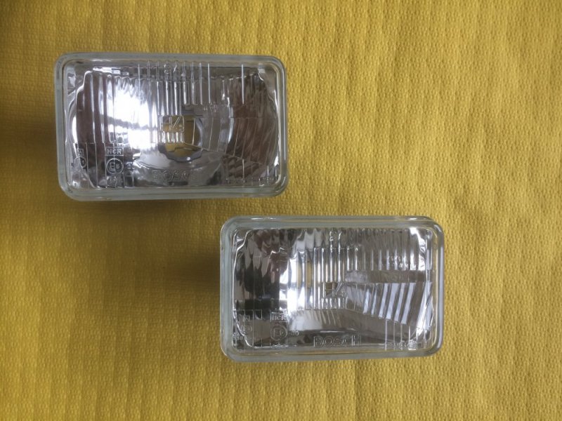

Just an update for anyone interested. The LMC conversion headlight housings are actually a very viable option. A friend of mine bought an 89 blazer with a set of the lowbeams LMC lights. I can actually say I'm impressed with them. They use 9006 bulbs, are of quality construction and actually have a very proper light output. I would highly recommend them if you cannot find the Bosch lights.
Just letting you all know, I have a contact that has a large supply of the the High Beam H4 bosch lights. They include the OSRAM H4 bulb in them. You can use them for both low and high beams, however they wont' have as good of a pattern as the lowbeams would so you can point them farther down.

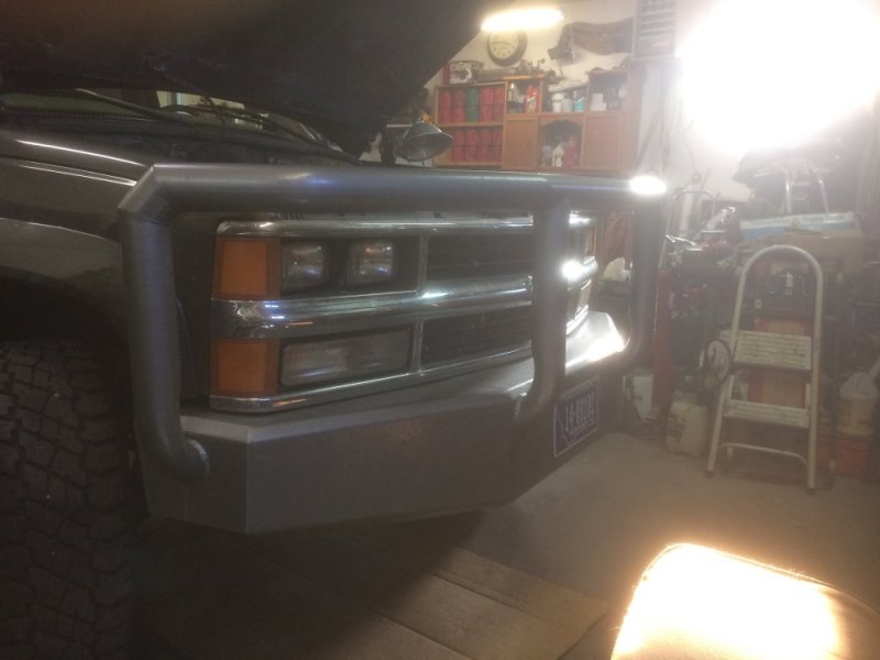

Several years ago I had pulled this system from a truck that was in the junk yard. I had it installed on My 93 K1500, before selling the K1500 I changed it back and installed this onto the K3500. I set it up with a relay so that when the brights are on, the dims also stay on.
It has just the basic over the counter bulbs installed, but, it sure beats the original equipment lighting.
