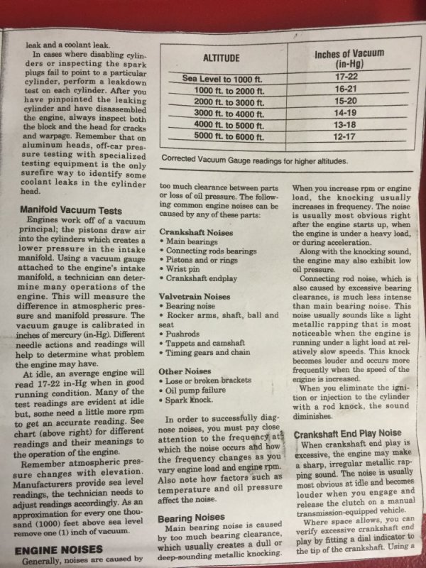

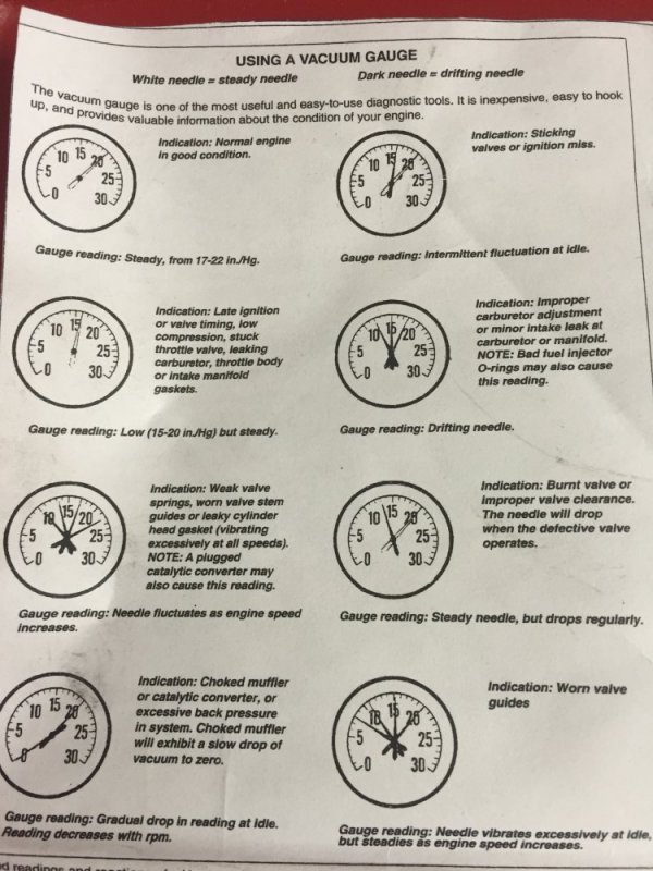

If those two turned up nothing, AK's vacuum gauge was the next test.

Just hooked up the light, hopefully to the correct plug on the coil. Since it was suggested to connect to the low power side of the coil, I connected the light to the smaller red wire that comes out of the distributor. That is the low speed coil control according to the factory manual I have acquired. The light stays on and steady through all rpm ranges sitting in the driveway. Vacuum is at 21-22 inches at idle with just a hint of flutter in that range. Probably the miss causing that. Taking it out later...
