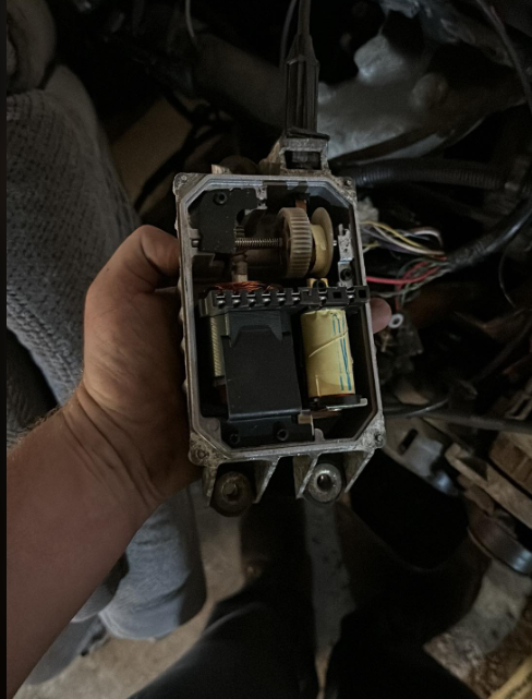

On some, the second bracket bolts onto the primary bracket you see there.
That is a db2 throttle bracket- just not set up for cruise control.
Idk what it takes to make a factory cruise control on db2 truck work on a ds4 conversion.
My hummer is db2, has factory cruise- but is all dismantled currently. Have to ask rockabillyrat for a pic as he has my ip currently.
Those CC modules are all the same, difference is the cables.
If that is a diesel CC and the cable is good, grab it.
The CC modules are easily found.
If your rig has CC already it is easy to wire up the CC module,
almost everything is already there.
The hardest part is finding the CC cable for a 6.5.
Do you know what year rigs the modules interchange?
200% agree about the cable- mine is frayed and stupid priced.
Civilian Hummer 1992,93,94,95 all interchange.
Photos in here of the pump I have and would plan to use.
