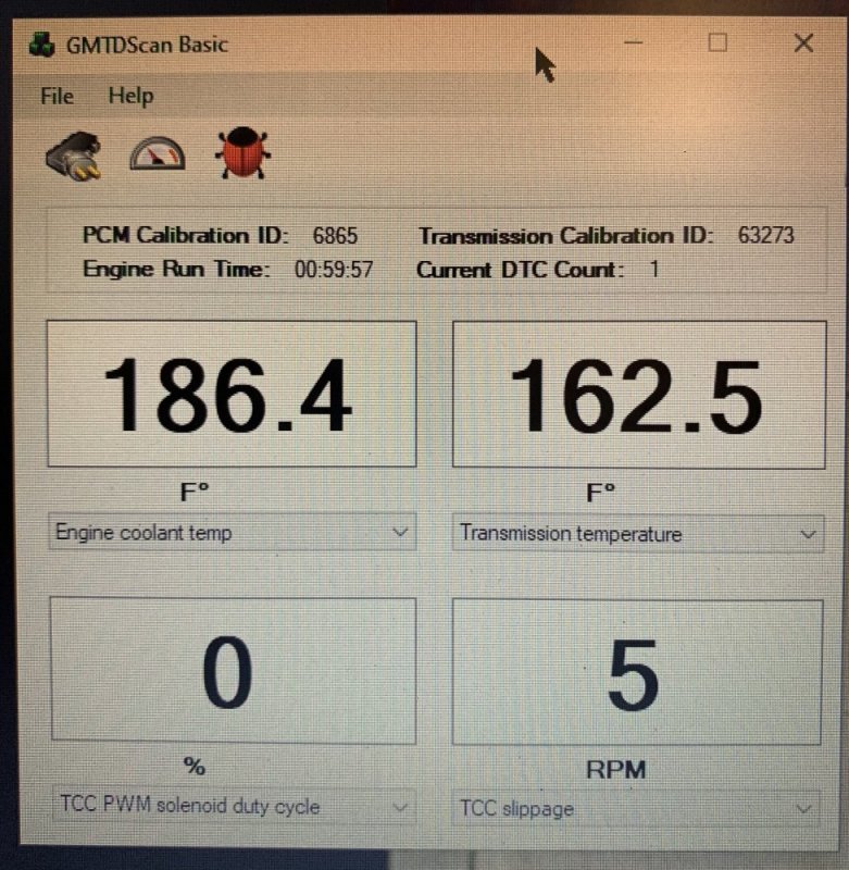

Update: got the fluid, filter, TCC solenoid, and the 2-3 solenoid replaced. Went for a drive and all went well no codes set. While I was driving I had the laptop monitoring the TCC pwm % and the TCC slippage and noticed that when engaged and cruising slippage stayed at 2-15. A minor press on the accelerator would make the slippage start climbing. It would go up to about 300-400ish before the TCC would disengage. I could also do slightly accelerated and hold it at about 230ish.
Is this an indication that my torque converter is weak and might be failing? All the while I was doing this no codes were set.

Is it normal to see the TCC pwm % reading go from 75 or so to settle at 6.5 when it engages and stays locked in? When it showed that after it settled the slippage stayed close to 2 unless I accelerate then the slippage climbs some. I’ll have to do it again to get exact numbers since I was just glancing at the screen and trying to drive
Mine went to 100% and then no slippage
Maybe I’m looking at the wrong data. Although it’s not connected to the truck in the photo but here’s the values I was looking at. The percentage would spike up then settle down to somewhere near 6.5 while cruising and the slippage would go down to about 2 When I accelerated the percentage wouldn’t move but the slippage would climb. I think I got it up to 250 if I accelerated any more it would climb up quickly and the percentage would go to 0 and released the lockup
I’ll have to put the rear end up on jack stands so I can watch it closer
