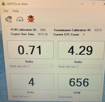

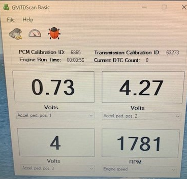

You can watch the voltages change, esp the % throttle commanded, as you move the throttle - should be smooth and linear without jumping to 5V or 0V at any point. ECM's also lie and report table data when a fault happens as automotive electrical is "noisy" and vibrates. So you may not see the fault until it is present for like 30 seconds. This keeps warranty claims down for intermittent connections that mostly "just work".

I see your point @WarWagon especially when I see these numbers on the APP with a drastic change in the RPM and the pedal virtually in the same position! I took these photos with my phone while feathering the pedal. APP signals are almost identical.
