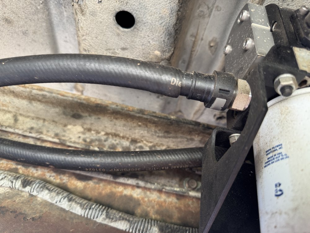

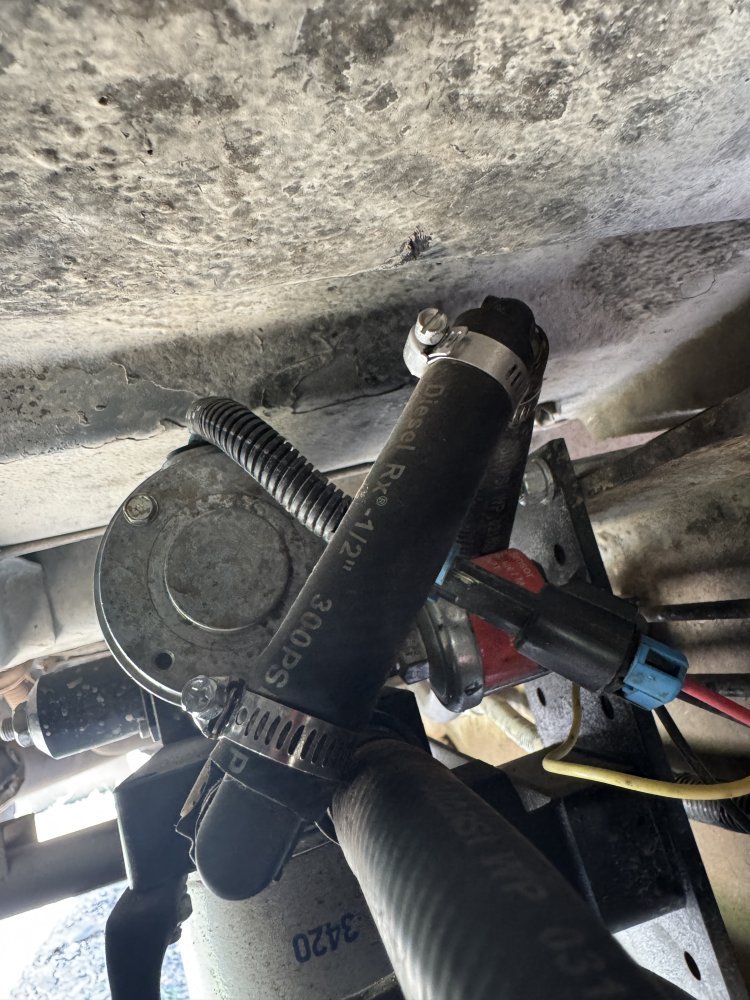

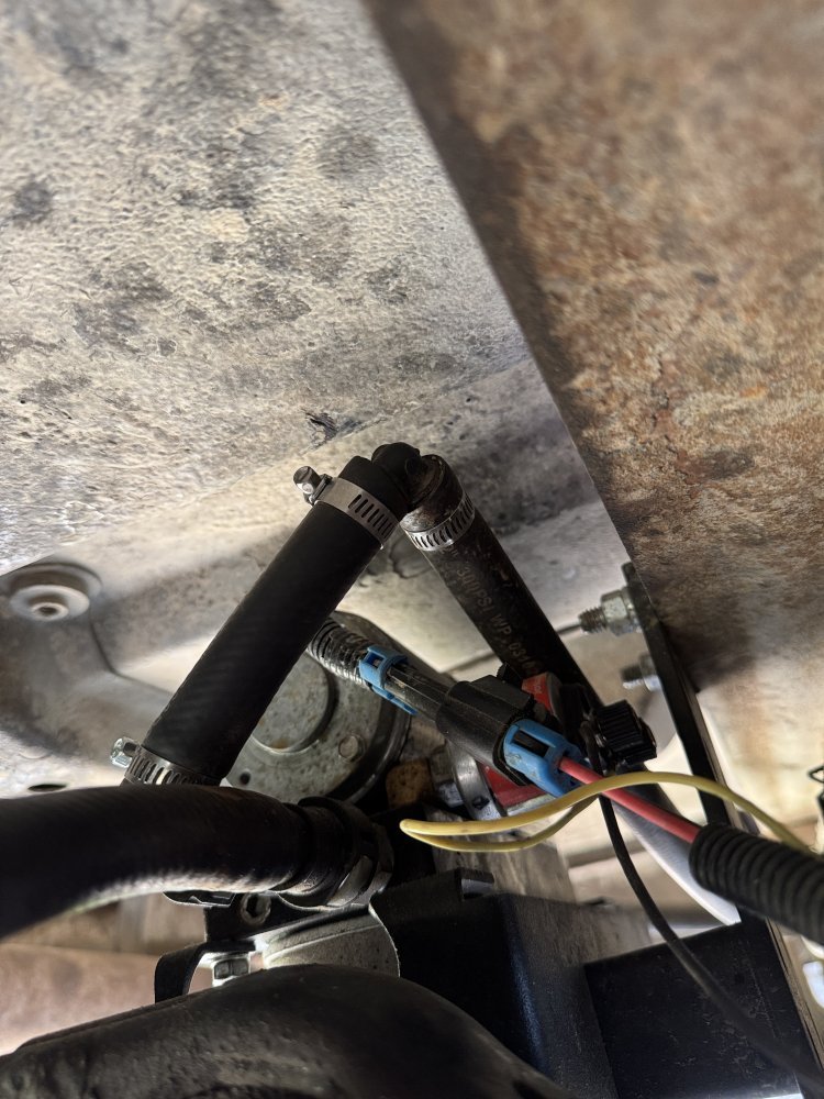

I went through and installed hose clamps on every connector and tightened them all down real good, didnt change a thing. Lifted the box and tightened everything over the fuel tank. Installed clamps on the fittings under there too.

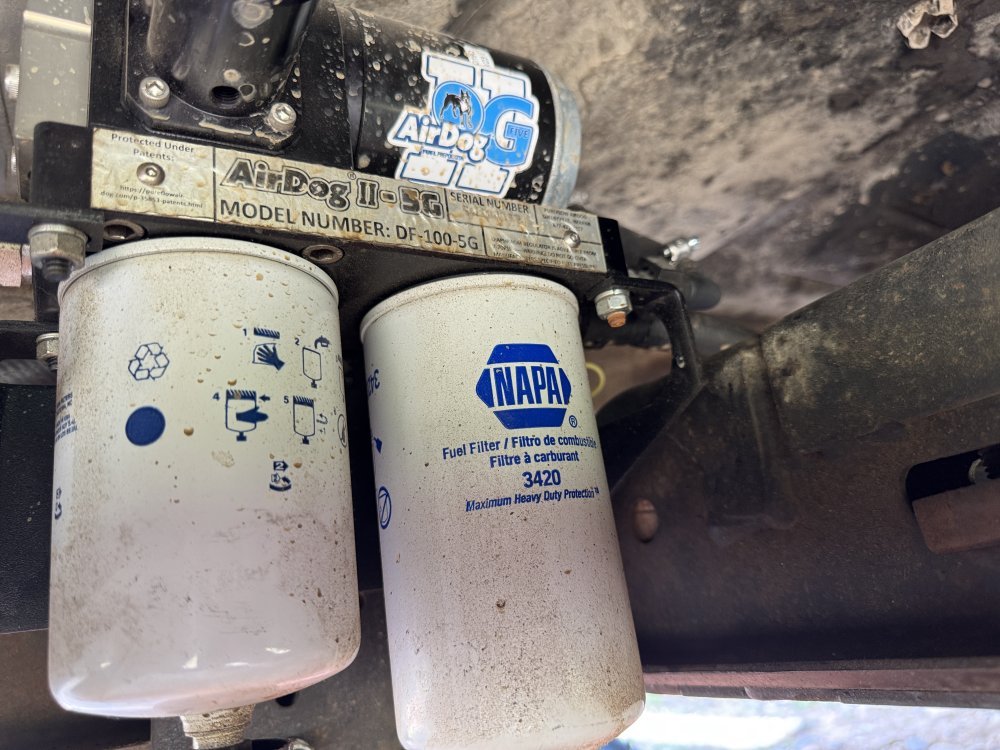

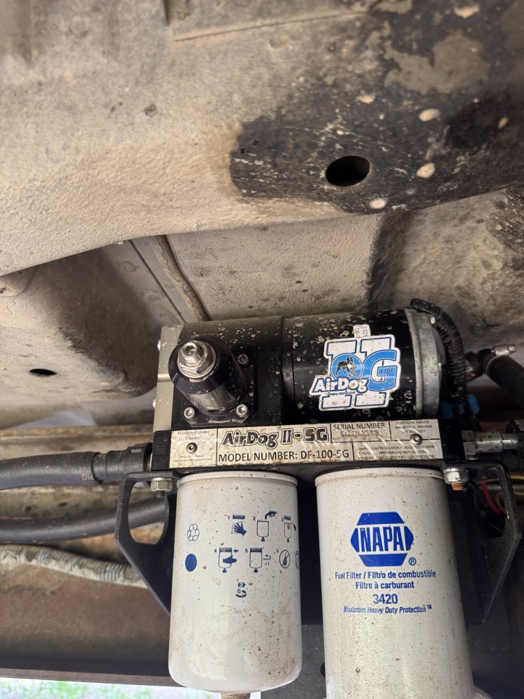

New AirDog lift pump system.
My son was watching the clear return hose and I was under the truck holding, shoving, moving and wiggling the suction side O-Ring fitting that plugs onto the lift pump. Didnt seem to make a difference.
Filters are tight and the water drain cock on the water separator filter is tight.

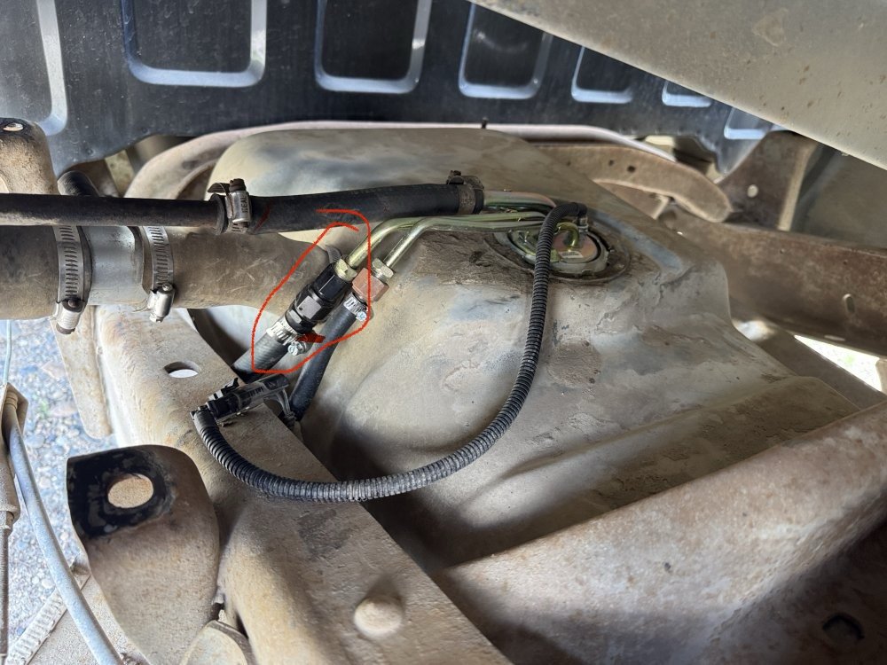

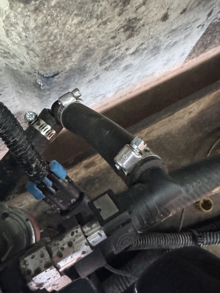

Circled in red should be your incoming fuel line to the lift pump. The o-ring here was always damaged with advanced age. The other fitting is your return line. I replaced both with AC Delco, which will cost you $200+, but you could just try new o-rings which you can get at Napa for < $10.
The rest of this run is at your lift pump.
If you were Will L go large with the clear line. His other suggestion going clear from FFM to IP is good stuff.
BTW what is that 3rd line at the top for?
