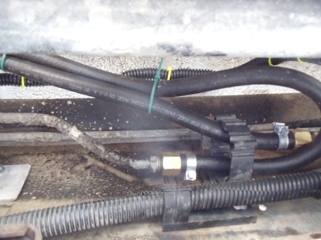

just an FYI on replacing the fuel pickup tube / sender in the tank. all of the aftermarket ones out there will work (application specific) but your fuel gauge will bounce around when on the road due to the fuel sloshing in the tank! I experienced this when I replaced mine. used the Spectre brand from RockAuto. there is an alternative that iirc Leroy Diesel sells called the metrum rod sender. it's a bit more pricy than the factory replacement.
I've just dealt with the gauge movement on mine, even though it moves with the stop and go traffic, I have gotten used to it and know when I need to fill up!
take a good look at the rubber lines that connect to the sender assy too and replace all the O-rings.
not to mention look at the inside walls of the tank real good. if you see any rust or what looks like shiny hairs in the tank, that is the lining coming off. the tank will need to be replaced. RA sells the complete tanks for around $130 or so.
The rubber lines that connect to the sender are permanently crimped to hard lines that get anchored to the frame. Currently you can get an SKB feeder on RockAuto for $56. Return line, I got a GM version off Amazon for like $106, whereas RockAuto was more and then they gouge you for shipping.
Dorman Fuel tanks on RockAuto are $181 plus shipping that takes it to like $240. I got a Dorman tank off Amazon for $183 with free Prime shipping.
As previously noted replace all the above due to the age of these trucks. Not a particularly hard job, but might as well do everything when you’re dropping the tank.
You can do that, but you will need to create some sort of "barb" on the steel lines so the hose won't slide off. I have seen hose clamped to a smooth pipe slide off under light amounts of pressure.
on the sender it's self, the nuts should slide back on the line exposing a flare that hold the o-ring in place. that area can be used as the "barb" so long as the hose is pushed over it and clamped on the other side. then run the hose longer over the tank so that you have access to them with the tank in place. use a tubing cutter on the lines of the truck then a flaring tool on the lines to make the barb.
a much better idea would be to find you some steel or stainless line of the same size to connect to the sender directly shaping them in such a way that the ends are accessible from under the truck. Meaning the sender would be hard lined over and down the side of the tank. then make your rubber hose connections there so the full length of the hose is serviceable without having to pull the tank or bed.
lots of guys in racing do this kind of work making custom fuel lines, you can even get a sender that would have standard fitting ports on them to connect flared hard line to and run anywhere you want.
Did the diesel rated line swap a while ago while doing the Walbro LP. I'm back to a stock LP but, the lines not OEM.
Leroy sells a barbed fitting 'kit' for the Fuel Sender Unit side. Just need the ones for the LP. I sourced what I needed a local hose and fitting store.
New parts arrive tomorrow, the bed is lifted, old sender out. Pretty sure the leak was in the sender supply line, before it turns into the tank.
