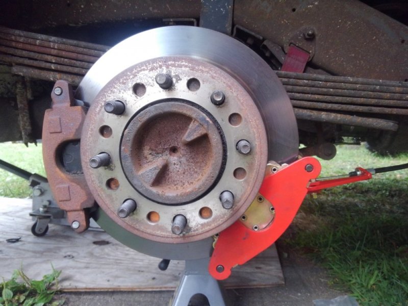

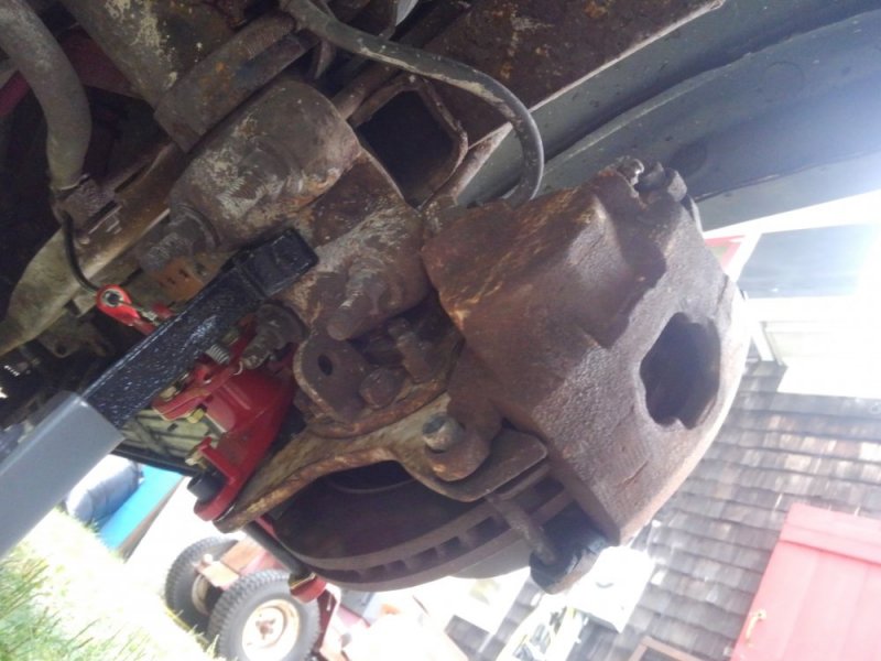

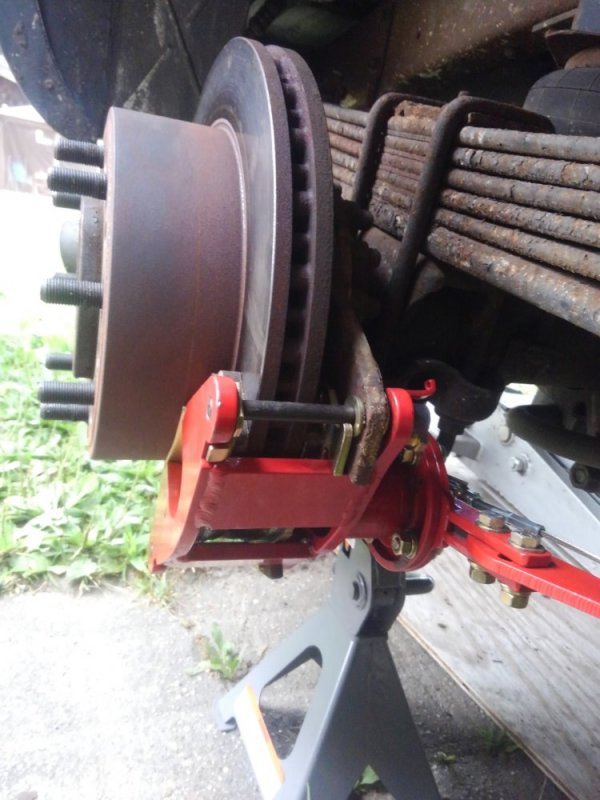

Yeah my TSM rear disc conversion came in at just under a $1000 all in, that includes a double caliper bracket and regular non caddy calipers and a separate mechanical E brake caliper. But boy am I much happier!
