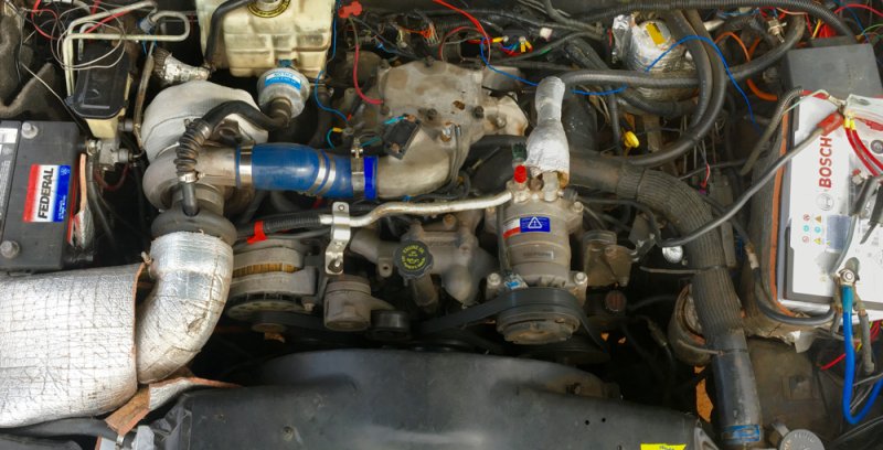

I have been suffering intermitent stalling for a while. Ute (Australian for little truck) usually starts instantly without issue whilst still rolling.
I ordered new FSD and Extension cable, new Pump pigtail, new Ignition key wiring pigtail, new fuel shut-off solenoid (on IP).
While waiting for shipping to Oz- problems get worse as in more regularly stalling (eventually daily) and wont restart quickly. Longer waits between start attempts are successful. Eventually almost impossible to get going (starts and then dies quickly). I have taken apart all wiring in engine-bay and checked and dialectric-greased joiners.

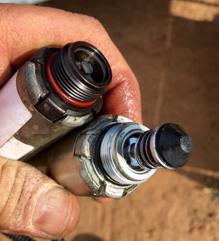

Parts arrive - I replace the FSD and extension cable (thanks Leroy), and the Fuel shut-off solenoid. I replaced the fuel pressure guage between filter and IP. I did some driving around the farm - all seemed good. In afternoon I hitch-up 5th wheel horse float, load and leave. ute drives 1000Meters and stops. restarts easily. As soon as I accelerate it stops. Harder to start after the second stop. This cycle gets worse. Quicker shut-down and slower to recover to be able to restart.
After thinking about it I checked the return fuel-line flow by pulling-off the hose from IP. Plenty flows out. Ute starts well and I return to farm with a few stops (gets drastically worse along the 100M trip). I used aircompressor and blew out return fuel-line with tank cap off: seems fine. I set off again and got further but still gave up and went home.
A day later I removed FSO solenoid and it seems to work fine. I can start and idle almost indefinitely. 6PSI on fuel pressure guage. If I gently press accelerator and raise revs (1000) the moter will die soon (20 seconds-ish). If I stab the accelerator it will die immediately. Fuel pressure observed to go up to 9PSI at engine dieing.
It's got me f_cked....
