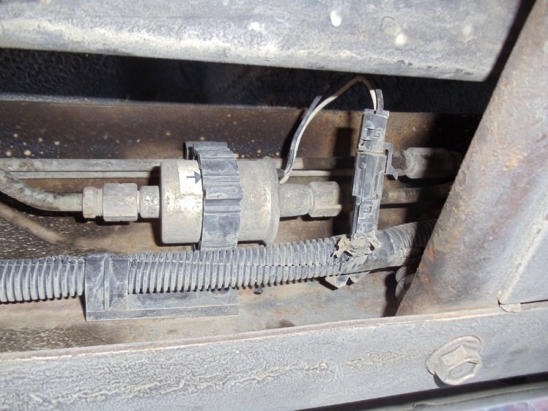

I have a 1997 K2500 6.5 F series Diesel, I replaced the PMD last year when the truck started stalling when ever it chose too, since I have had no issues, everything is stock no aftermarket stuff. Yesterday I went out started my truck drove about 20 min to a job, went out 30 min later and the truck wouldn't start, like it wasn't getting fuel. I opened the bleeder on the top of the fuel filter and got some air then bubbles and then fuel, after a few attempts it started. I drove it home and it was sputtering and very rough. I took the fuel filter out (which was replaced approx 1 month ago during normal service) checked the seal and put it back on, I turned the ignition forward then bleed the air through the bleeder valve and then attempted to start the truck, it started and I drove to my next job where I worked about 5 hours got in started right up, and it was fine all the way there and back, stopped at the gas station turned it off then same issue again, messed with it for about 15 min and it started and ran rough and sputtered rest of the way home. This morning I started it for warm up and it ran about 5 min and shut off now it wont start. This is my first diesel and I am not familiar with the abbreviations some of you guys use so please explain and if possible help me out. Thanks I appreciate any input. (side note I did relocate the PMD when I changed it) Thanks Jason
