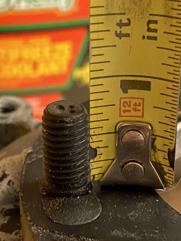

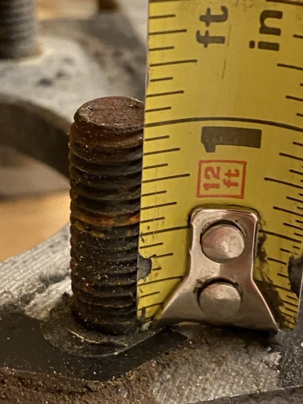

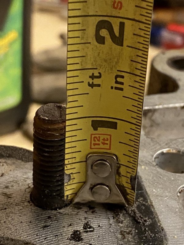

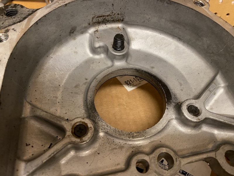

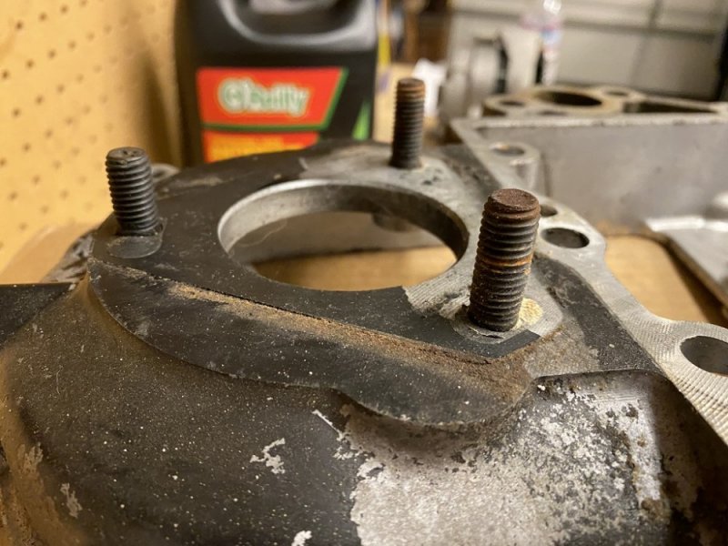

I am concerned this stud could have gone in far enough to contact the IP gear. I provide pics of the area in question with measurements. Just because I have some sitting around... IMO You can correct this by double nutting the stud and threading it back out. But it's got a non-threaded shoulder area that should NOT allow it to go into the timing cover at all. Note it's a different height than the bottom two IP studs. Closer inspection to see WTF is going on is in order.
top stud
Bottom two IP studs:
After you correct the height: With the oil filler off have someone crank the engine and verify via a mirror the IP gear is actually spinning. Sheared key or broke timing chain is possible if the stud locked the works up. Although if it spun with the engine to get the IP gear bolts off you should be ok.

Looks like you put the short stud in backwards, with the long side past the shoulder going into the timing cover instead of the short side. Thus, too much sticking in and hitting the timing gear and and not enough sticking out to thread the IP nut onto completely.
War Wagon,
Thanks a million for the pics. Couldn't find anything with the stud/bolt lengths. After manually cranking it and looking through the oil fill I decide to go for it and put it back together and now she's purring like a kitten with the new ip.Thanks for all the help on here. You guys rocks!
It had to have been done before I owned it. It's the first time I've had it apart.
I would cut the oil filter open on the next oil change. If you have magnetic filings in the filter media I suggest the stud would be rubbing the IP gear.
It doesn't take much to turn the stud around as @Husker6.5 suggested is the problem of backwards. Why didn't I think of that? 🤪 Look for the shoulder being on the IP side of the cover because they could have installed it inside out: from the inside of the timing cover.
Or, they threaded it in from the outside like the bottom ones, but threaded the long side past the shoulder all the way into the cover down to the shoulder bottoming out and "jamming" the stud, leaving the short end past the shoulder sticking out and barely reaching past the IP body. Thus, the nut barely has anything to grab onto, let alone having the threads sticking out past the nut like they should.
