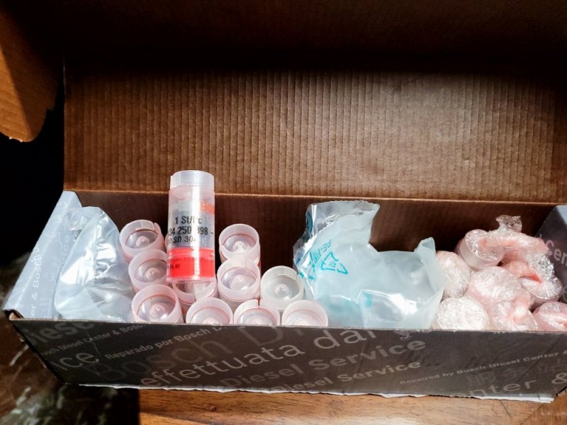

nozzles was found to a dealeder in Italy, he had these "Bosch made in Brazil" nozzles in stock for a long time, many years, and after about two years from the first contact he hadn't sold even one, .... I realized he wanted to get rid of them, I made an offer for all of them that he had in stock (22 pieces). and now I think I have solved how to rebuilt the injectors for life

No....nozzle was bought alone from a Bosch dealeder

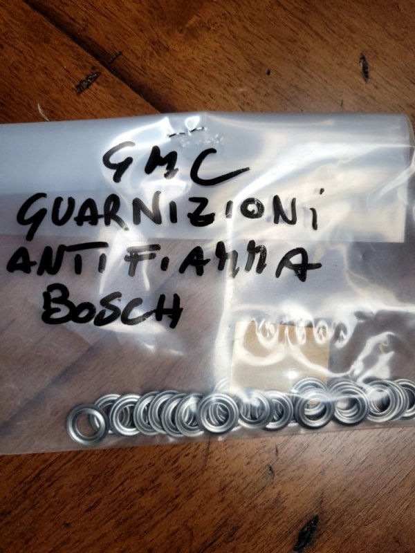

and shims was bought from Star Diesel...you can choise all you need for ....my choise was 0.05 mm, 0.10mm, 0.20mm to add to exsting deep shim...but you can also choise for a deep rectified shim as deep as you need, better choise if you have a complete shims kit ...if i remember well from 0.05 mm to 1.98mm. but it is not cheap.
if you add small shim to existing shim, remenber to add to injector body side and not to coil side. coil can easy destroy the small shim
for what i remenber when i did pop test the injector a 0.05 mm shim change the pressure of about 130 psi. for your refence

Yes .... nozzles are individually packaged and sealed, normally packed in 10 pieces box.
this is my stock with Bosch brasilian sealed nozzles and made in India nozzles removed from new injectors and stocked here, if needed.
