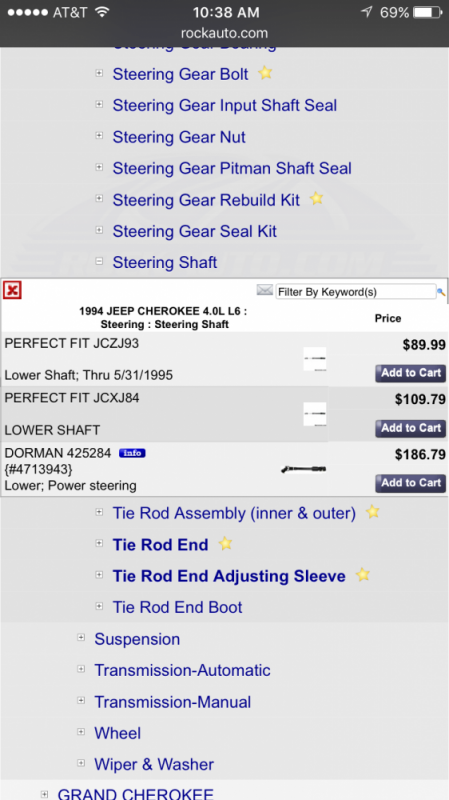

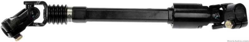

What about just buying a Dorman lower shaft for the '94 Cherokee for $187 off Rockauto?

You can normally pick them up used for $25-50 in a junkyard. If you're using it for a 95+, then all you need is the lower portion that doesn't normally wear out. If using it for a 94 or older, then I would look to a new one. You can pick them up new for alot less than that dorman. I believe crown carries them for $90 or $100.
Rockauto had another model made by Perfect Fit for $90.

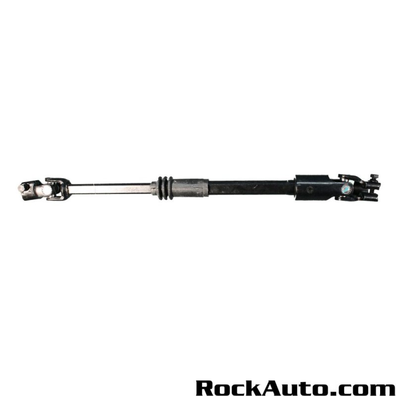

This is listed for the '94 Jeep Cherokee:

Just make sure it's the early style as I know one member here got one out of a 95, and it was clocked 90 degrees out.
This is what they show. Looks different than what I just replaced.
