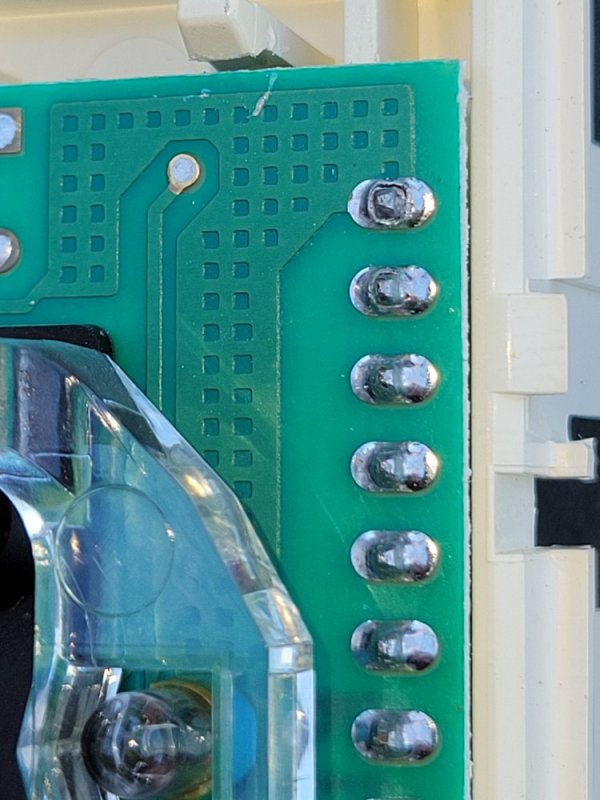

I pulled switch apart. Looks like the top 2 prongs are broken or cracked. I wonder if I resolder these if the switch will work?

Have the soldering iron hot enough to melt solder, touch some solder to the tip to be sure. Touch the joints and give it a short dose of solder. It will hold.
I am shaky and dont see so good some more. I soldered together a complete DIY Autotune control board for gasoline fuel injected vehicles.
If I can dooooit, You surely can.
I am sure that the cracked solder is the problem.
Square body GM pickups, windshield wiper motor joints does that. A quick solder job and good as new.
The gas log fireplace in My front room, the gas control valve crapped out. Them things aint cheap. I thought, what the heck, its no good the way it is. Removed a cover, broken solder joint and the wire had moved away. Poked the wire back into position, soldered it down, probelm free for about ten years now.
I soldered the connections, still didn't work. I bought a new switch, still no worky. 🤬

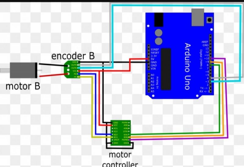

I would love to get a wiring schematic for the wires going to front actuator and encoder motor to find out exactly which wire is the ground.
This is a helpful link.
