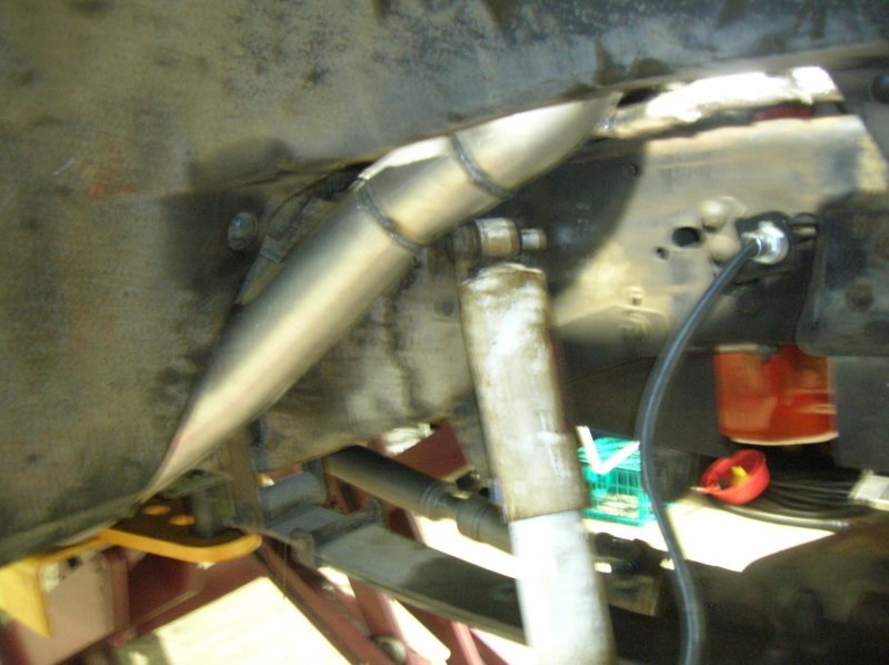

Finally getting close to running the truck down the road. Exhaust system for a 88 and up, used most of the parts other than a few L's for the turbo down pipe, trimmed the inner fender a little and had to do a quick hack job on the cross over pipe to clear the front shaft.
Was a loggers truck back in Idaho so the cab's a mess but new mat, freshen the dash, get the instruments working and fresh paint, it'll be a good old ride.

Test beat today, after a couple of days of details, like some one switched the heater control cables once, lets just say I've gotten pretty good at dash board work through repetition. Got the tach interface coming from Dakota Digital, other than that every thing works in a way.
Boost was only 4# with handy spring, locked it, shows 12 w/pyro @ 600f. Pipe sounds good, quick enough for me. Had the pump set @ 3500 rpm, might live a little longer that way.
