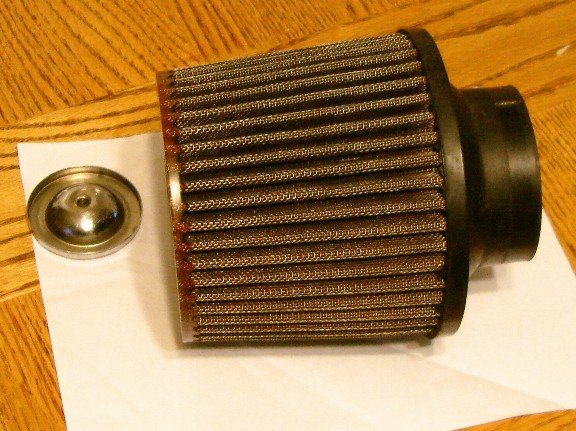

I had one on my truck when I first bought it. Research showed it could be had for about $25 from SS Diesel prior to 2007.
It was an unknow feature built in to his early versions of a ”Cold Air Intake” only it wasn't supposed to be an air cut off device as it was the air filter.

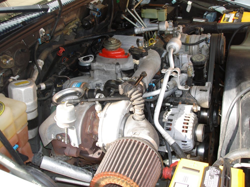

(Old picture of the motor after I bought the truck off Flea-Bay in 2007. Note, the 'remote PMD Cooler' on the intake. I've learned a lot over the years.)

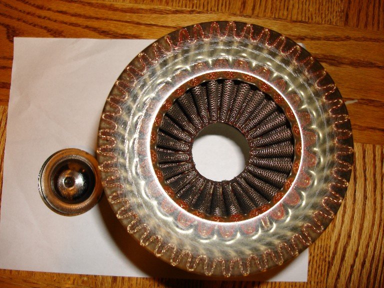

Plus, when it went 'off script,' it wasn’t command activated. At any random time the glue holding the metal cap on the cone portion would fail, the metal cap came off and blocked the turbo inlet. I got lucky and it just perfectly sealed the inlet like a bottle cap.
Others weren't so lucky as the metal went edge first into the Turbo's impellers giving one an excuse to upgrade to a “Wiz Wheel.” Not the 'spirograph' etching from the center shaft. I was very VERY fortunate. Yeah, a perfect fit and seal that had me chasing 'stalling for over a month. Could have been worse.
