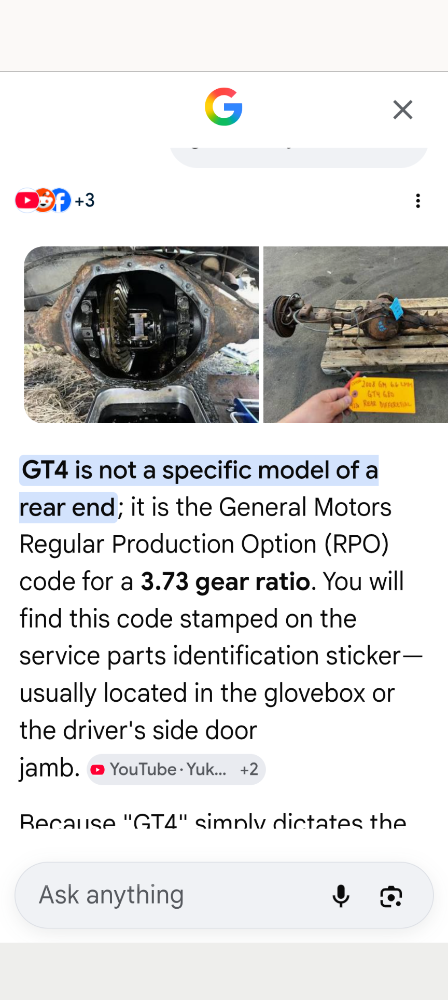

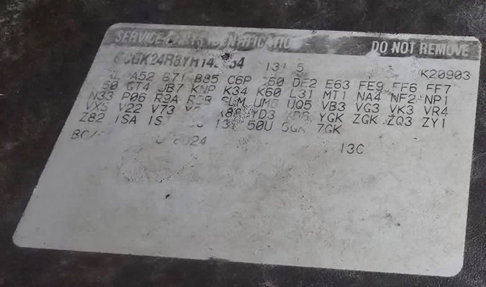

A guy over on Roundup is scrapping out a K2500 pickup.
I was wondering what the gear ratios is on that truck.
Had him snap a pic of the sticker.
I know nothing about them codes.
Can someone please tell me what gear ratios this truck has.
Thank You in advance.

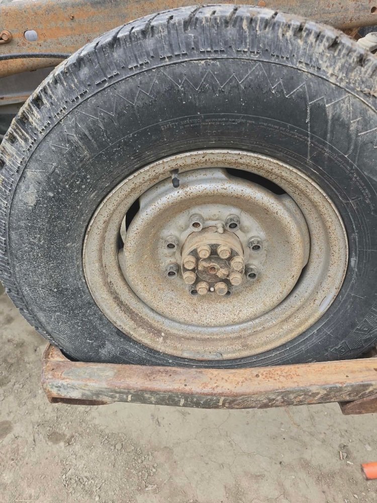

Roundup is probably about 100 miles over from MC so I’d have that fuel plus whatever we can negotiate for price on his rear differential. I’d take the complete unit not just the gears.
Next think IDK if the rear out of his is a full floater.
Next question, my truck at 70MPH is right about 2,000 to 2,100 RPM.
With the 3:73 gearing, whats other peoples tachs running at about 70 ?
Is it worth switching over to the taller 3:73 gears ?

If the 2500 has a full floater diff, it should be the same as our 3500's other than the brake shoe width. if's it's not a full floater, then it all will be different. it will fit, but bearings and all will be different size.
