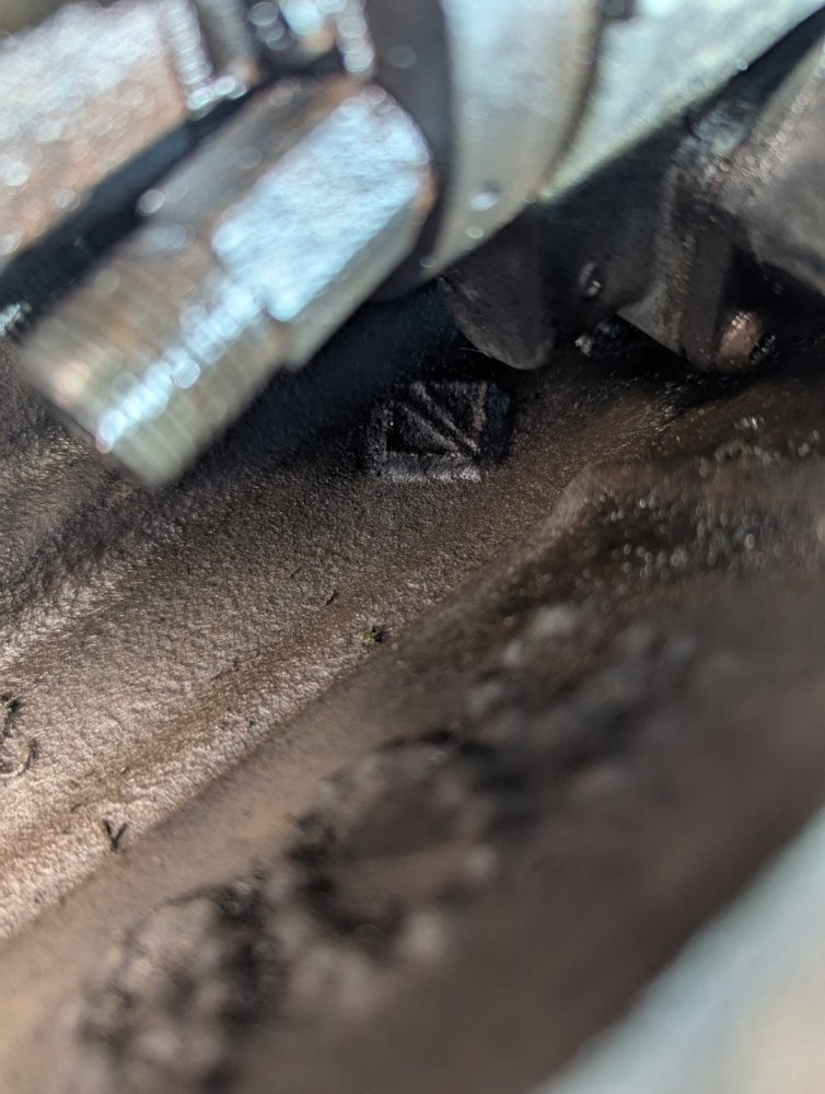

I rolled out the mains and am wondering if anyone has recommendations for rod and main bearings. I'm not looking for the cheapest option.
Also, since I don't know the 6.5 production history, I'll ask about my heads. I have the International Optimizer block dated 2003. Was International making the heads then too or just the blocks? I have the diamond pre-cups, but, apart from that, I don't know anything about exactly what heads they are. And does it matter anyway?
They made the heads too- better than gm heads but still can crack between the valves from heat. This is a likely location for the combustion gas into coolant. I’m now of the opinion that any head other than p400 heads will get the brass tube insert into the steam pockets. It simply seems it is not a matter of if but when every head begins to crack there. Such a simple solution to buy a ton more miles once the cracks start.
I prefer King bearings when possible, but there are other good ones.
Again- don’t buy any yet until it’s all pulled apart & inspected. You could have a cracked block in cyl 7/8 or something still unknown.
