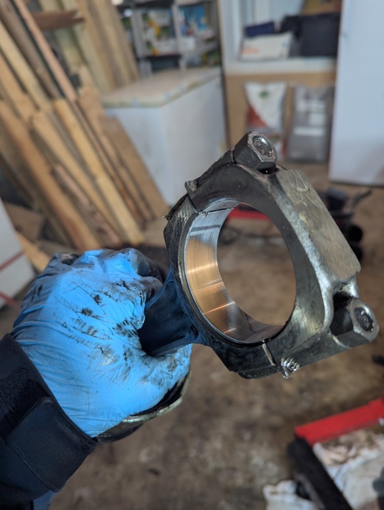

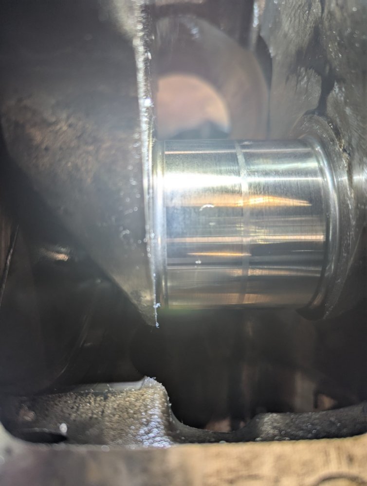

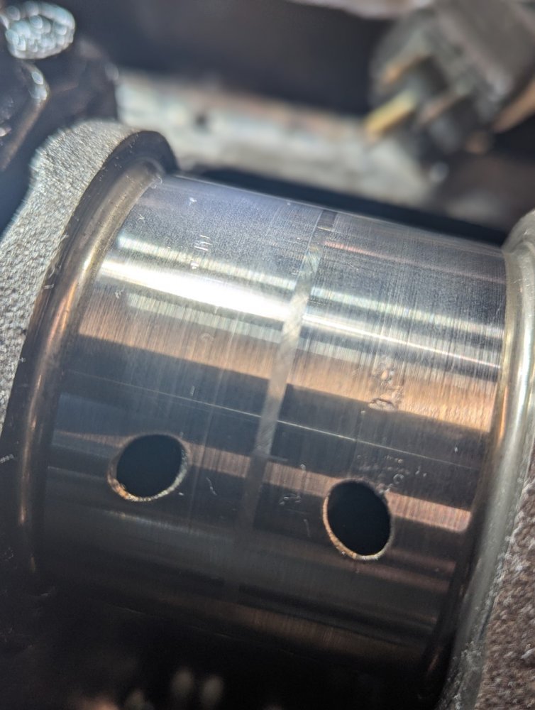

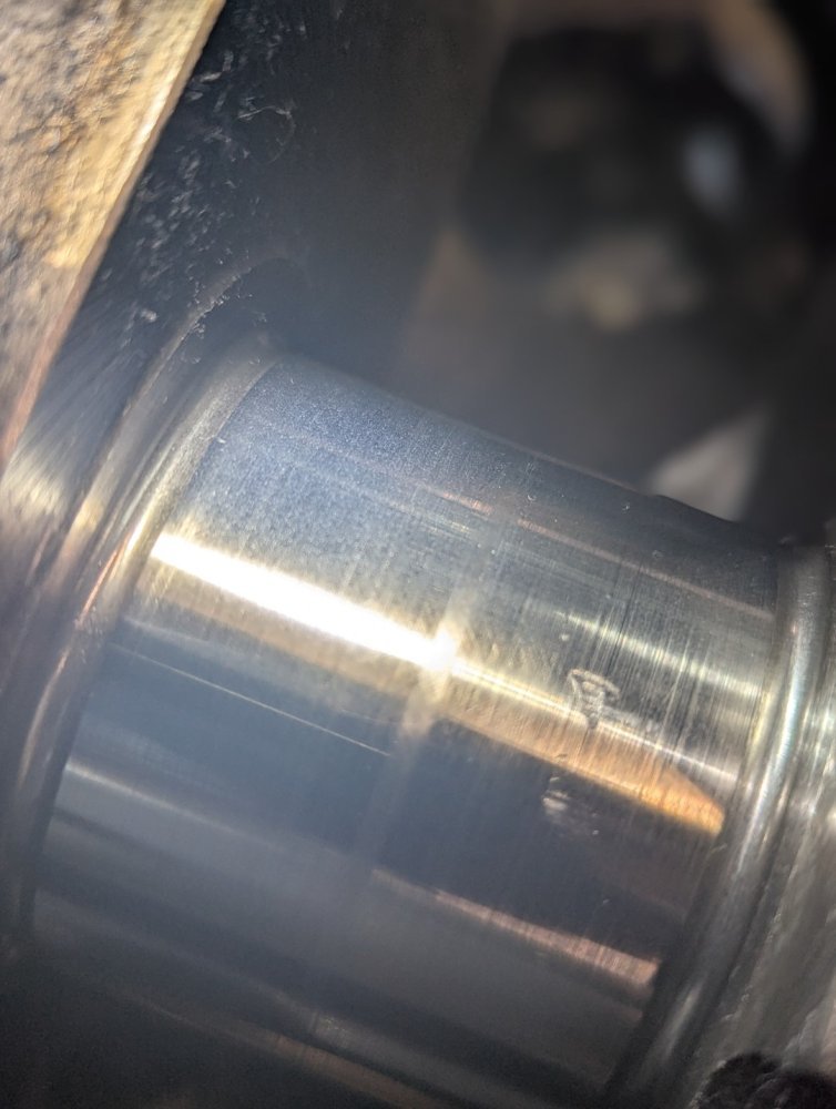

I got the pistons out. All the upper bearings show copper like the one in the photo. I also have a few nicks on the crank - I know I did two of them. Am I looking at getting the crank polished, or can I gently smooth them out? I don't intend to keep my rig forever and don't use it much or really push it.

Have it polished & see how far it would have to go to fix the nicks.
When removing or installing conn rods- put rubber or plastic protectors over the rod bolts- few bucks is a smart investment.
Are you balancing the rotating assembly? A wise investment if you can afford it. When they do this usually a crank polish is a tiny add on.
