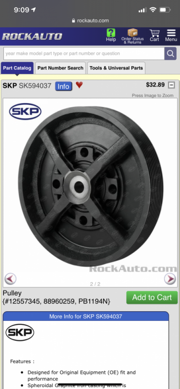

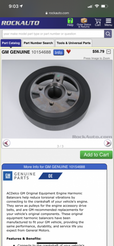

On the Delco balancer- I am still WAY LEARY of RA because of the known knock off stuff that came from there. So if it is a real one- great price. I would call 1-800-acdelco and verify they are selling them to RA.
On that SKP - SKIP it. If someone was on money hurting status then ok. But you are replacing it in 30k miles.
AC Delco is not selling them to RA. This does not mean they are not AC a Delco parts, but AC Delco cannot verify them. AC Delco bought off Amazon are legit.

Just relaying what AC Delco said when I called about buying their injection pump from Rock Auto: they cannot verify legitimacy of the parts because RA does not buy from them. They steered me to Amazon for the IP a which was the same pice, with no shipping cost and no core charge which is easily $125 savings. So it was a better deal off Amazon and I know that I have a two year warranty that AC Delco will honor.
