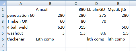

By the numbers its comparable to the other top name brands.
Mystik JT6 says it buttery smooth. It doesn't mention Tack. ????? Washout is low.
I know its hard to get excited about grease as any grease it better than no grease. Seems to always be a trade off on characteristics.
