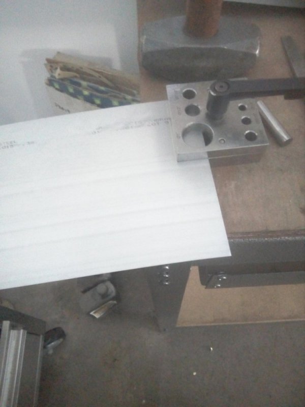

So after not being able to get any of the fuel companies to answer my ?s, I decided to play it safe and got steel shim stock. Got the 4 I already had done reshimmed and will hopefully do the others tomorrow morning while it's still cold outside.IMG_20170323_173925.jpg

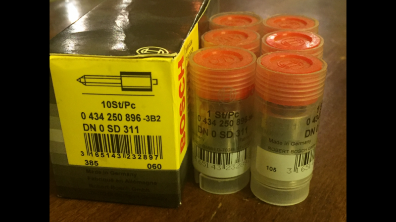

Leroydiesel.com sells complete Bosch injectors. All Bosch are now made in India.
They are good quality, but the very best ones are no longer made. If you can find these nozzles on ebay- grab them up. Last time I got ahold of 8 sets and sold 6 off to guys here at my cost. See pic for part number.
Thanks, not much on ebay just now, 2 from Latvia and 1 from Australia, and $45 each. Might as well get the set of complete injectors from Leroy.
