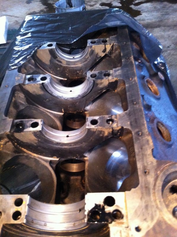

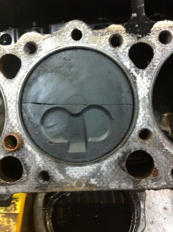

This is my #6 piston, I now see why there was only 25 psi compression. Tomorrow I'll finish tearing it down and check the main webs.IMG_0482.JPG
Those supposed marine injectors by Hector have standard nozzles in them, he didn't have a good rep IIRC.
I don't see any sign of melting. (Maybe lower right corner of the crown?) Did the cylinder get scuffed?
Just fatigue or minor casting flaw comes to mind. Otherwise oil failure causing a scuff condition that cracked the piston from stress?
I assume you cleaned the top because it looks like a valve hit if you didn't.
Never cleaned it up, I haven't looked at the head or valves for damage. Oil pressure has always been good. Cylinder looks to be OK on a quick glance.

Can't tell from my phone- is that a valve stamp mark?
The indent in the valve relief Will? I haven't looked it over much yet, got the heads and pan off is all, then it was time to come in.

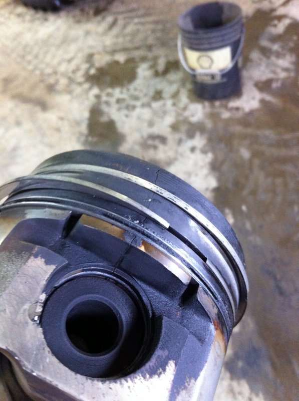

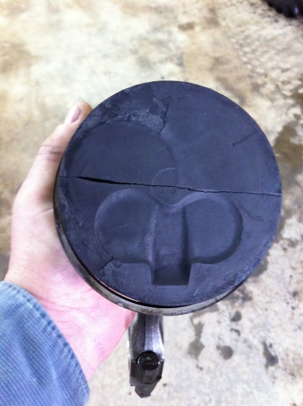

Here's some pics of the piston out, I guess I'll be looking into Lock n Stitch or a new block. One wonders how long the cracks have been there.

I see that piston has become your avatar. :D Bummer about the block. I often wounder how many crack free 6.5 blocks are even around any more. Thats excluding the Optimizers of course.
