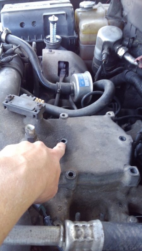

So as long as it doesn't go above 12 on the gauge before it drops I'm okay..... Now hopefully this is my last dumb question of the day.. should I drill a hole right in the middle of the plenum or on the tube that goes to the turbo..

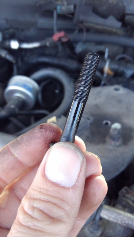

I'm pulling the plenum.. when I took that bolt out there's a whole lot of oil on it....

Ok so I learned a couple important lessons yesterday..1) guy at hardware store don't know squat about thread size...(he gave us the wrong thread tap.) Didn't figure that out till we tried to put the fitting in the plenum and it wouldn't thread in right..so off to the junk yard to find a plenum..4 junk yards later I got one..(actually found a bunch of 6.5s there) never heard of the place before...anyhow. Got the plenum but left my phone there..so just left there with my phone ....thank God there a mom and pop place and live close to the yard or I would have been phone less till Monday..lol ..
round two.. let's try this again.
Success!! It works!! ( i Think). Got a little oil came out from around threads at first but seems to have stopped..I've only had it up to 9 on the guage do far and it didn't blow open...gonna run her up a steep hill and try...can set boost level if can't get her up to that level...BTW..any suggestions on vac lines?..the one that came with it seems pretty flimsy so I don't expect it to last very long.
For the line to boost gauge, I use copper line- 1/8”. Sleeve it with fuel line or some other hose to keep it from rubbing through because it is so soft.
