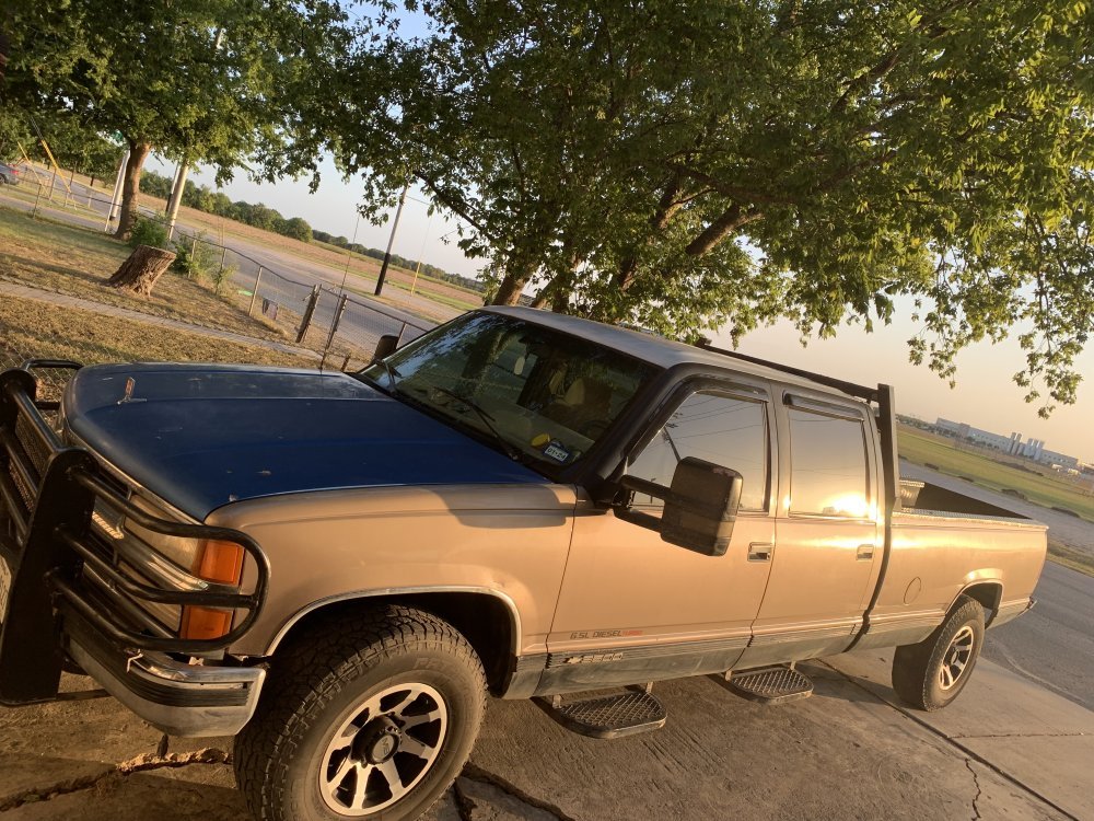

I don't think I have posted a pic of my rig in her current state or at least a full body pic since I joined the forum.... so here she is in all her beauty, multi-colored and all LOL.
This is why I say she's less likely to get broken into than a nicer looking rig. HAHA!
I just gave her a bath on Sunday, the birds have already began to redecorate...
