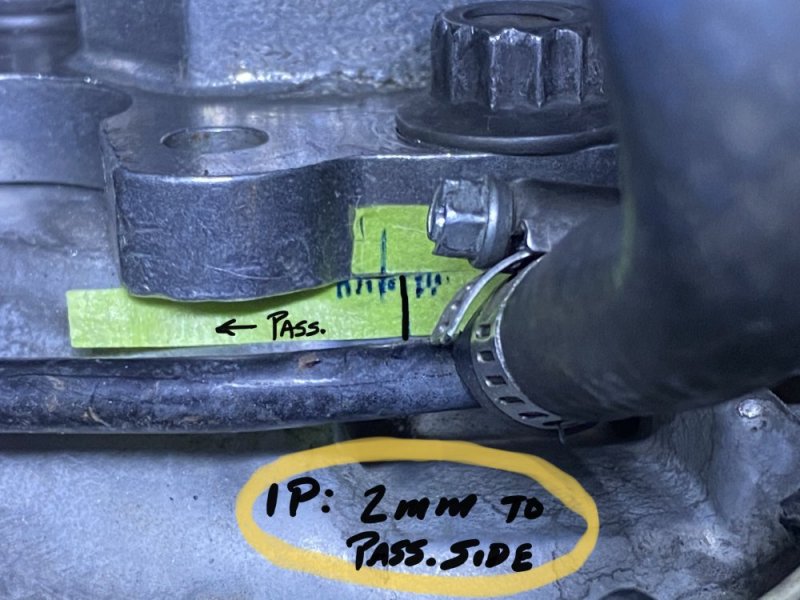

My IP Times (Actual and Adjusted) read in the 11s or whatever even after I did the IP Time Set and got it into the 3.5* desired range. When you activate "Time Set" by hitting the 'On' function, the Actual number is supposed to drop to 0.00. During the IP timeset function, you need to watch the readings as they will fluctuate... changes by a couple of 10ths in about a one degree span (eg. 3.0, 3.3, 3,7, 4.0 etc.). If it the readings during the "Learn" command are above 3.5* then you need to move the pump towards the passenger side fender. Rinse and repeat (I was at it over 9 times this last go round). Once your readings are fluctuating between 3 and 4 degrees, then you can set the IP Time. While its bouncing around between 3 & 4* get ready and hit the command 'off' button as soon as the readings hit 3.5* (you gotta have gamer reflexes or it will be a multi attempt effort). Note, unlike the TDC Learn function, IP Timing set procedure won't end until you hit 'off.'
Once you get your IP timing where you wants it, then you can go to the TDC Learn function for more fun.
Starting value will read "0.00" and when you hit the 'On' for starting the learn process, the engine will cough and sound like it wants to die, then steady up a bit and chug a little for about 20 seconds until it is through (Command State: None). Then you'll have your TDC Offset Value.
I finally got the IP set to 3.5* (the actual and desired reads 11ish once leaving the the Time Set screen) and the TDC went to -1.94 after being stuck on stupid at -2.46 for over a week of different tunes and IP position changes. Unfortunately, the truck is running worse with the new IP and so I have other issues apparently.

I used the 3/8" bolts, about one inch long with a nut threaded all the way up to the head. That allowed greater control without running into clearance issues as well as stabilizing the bolt as the nut stops the bolt from 'drooping' and thus, falling out. If you find you need to rotate the IP to the passenger side, only one one bolt in the bottom hole is really needed.
Just use the top nut to secure the pump from moving as you seek the magical 3.5* IP time set. It will hold. Snug up the bottom two until ready to lock 'er down.

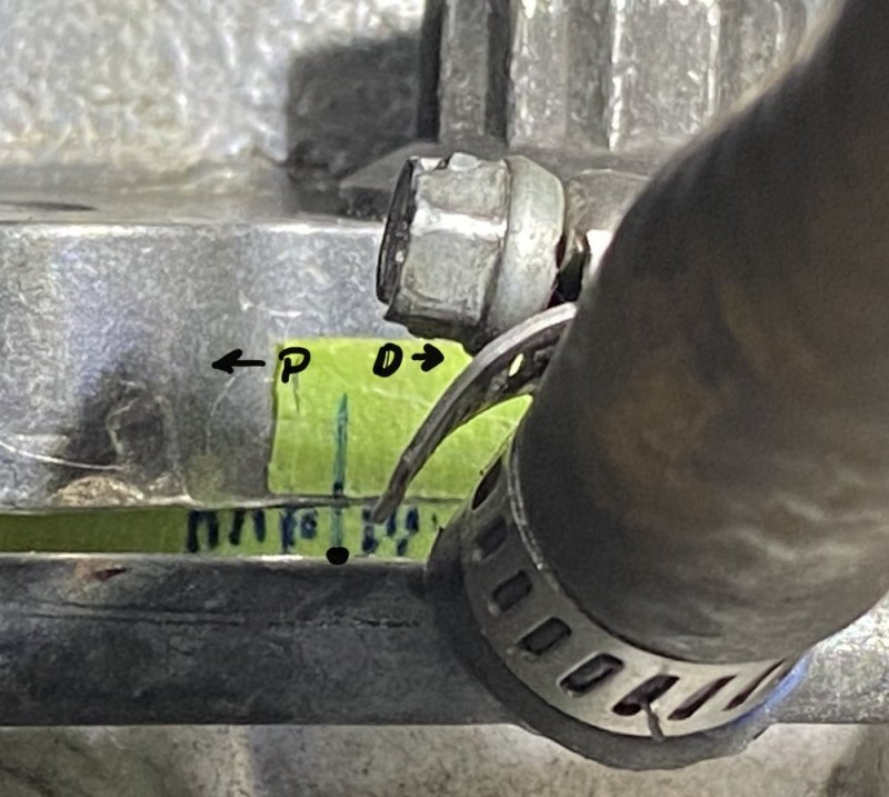

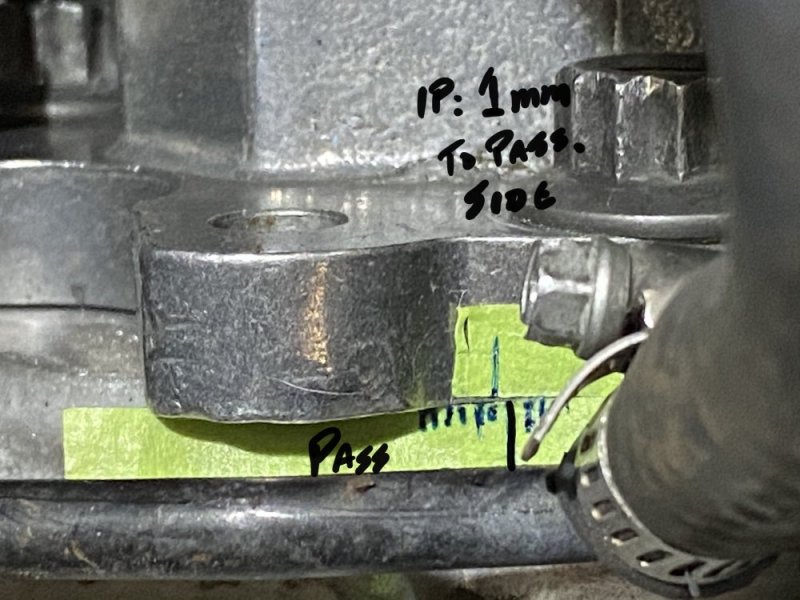

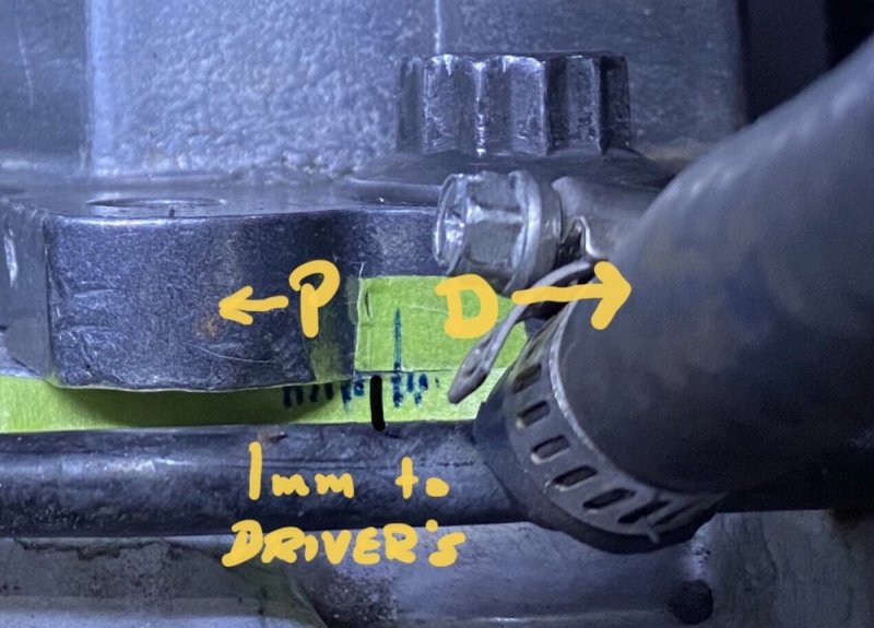

I saw the actual and desired time readings (prior to the Time Set Polka) drop to about 9.5* Actual with desired sometimes following but, mostly hanging a coupe degree's higher as I moved the pump to the passenger side. As you get closer to the sweet spot, you'll see the Time Set function start to respond to the 'On' command. Too far to the driver's side and it will kill the motor. Likewise, too far to the passenger side and the TDC learn function will kill the motor when activated. For my efforts, it was a delicate balance which is why when you get close to 'bingo' your pump movements need to be measured in hair widths. Not joking.
To aid my efforts, I cleaned the surface of the IP and t Timing Cover. I then placed 1/4" strips of painter's tape on both the IP and the Timing Cover. The tape was pre-marked. IP's had a single, narrow, reference line and the Timing Cover's had a long line with 1 mm (ish) reference ticks. Helped as the loosening of nut between adjustments will cause the IP to self adjust given the springlike tension of the injector lines making it move back. "Pictures or it didn't happen...."
Best wishes for success. It sounds tiresome but, with healthy system (unlike mine) it will be a lot easier than it sounds.
