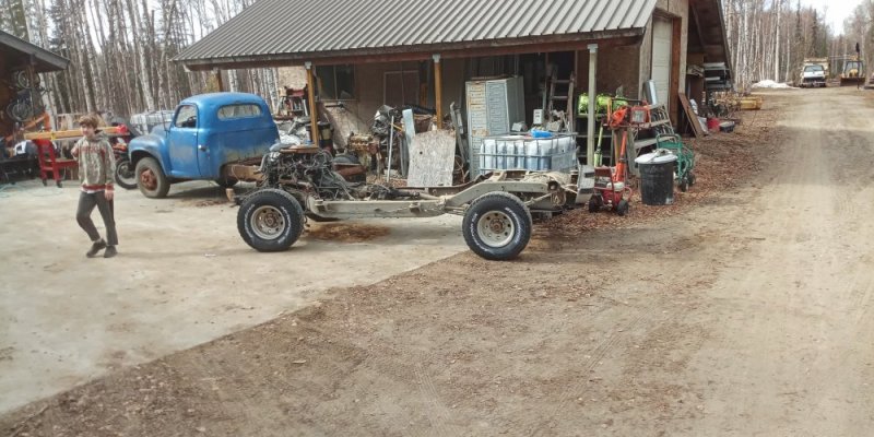

So it might be premature ,since we don't even have the body on the frame, but I have a question for you gasser guys. Been trying to decide what to do electrically on this rig. Should I try to use as much of the Tahoe wiring as possible or go simple and do away with alot of it? I guess along with that is the early TBI a good set up? Or should I be looking at something else. I actually thought about carbing it but then I need a way to lock up the TC. Any thoughts are welcome.
Tbi failures of the past are fairly easily fixed nowadays. I would keep the entire harness since it was a running rig, even the dash. Anything comes up in the future its a 198x tahoe. Just the body itself to be the Studebaker.​
I agree with Will. I will add that there are some places that do TBI tuning so you don’t have to keep it stock if you don’t want. I found this place when thinking about another project and I thought they had a lot of good info.

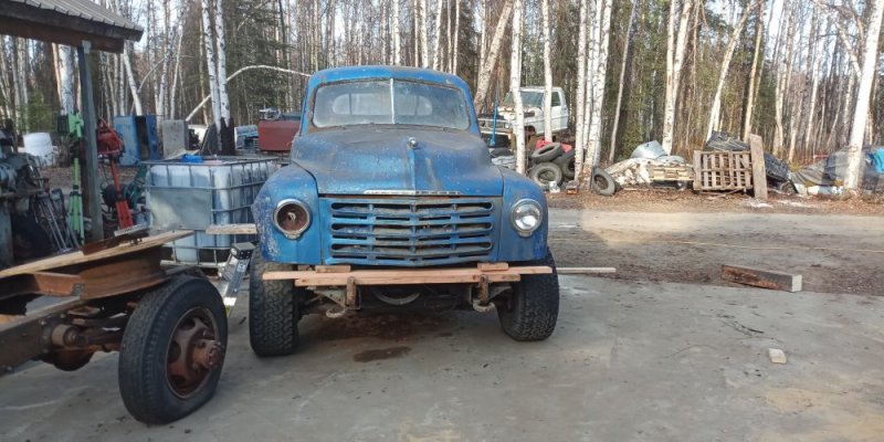

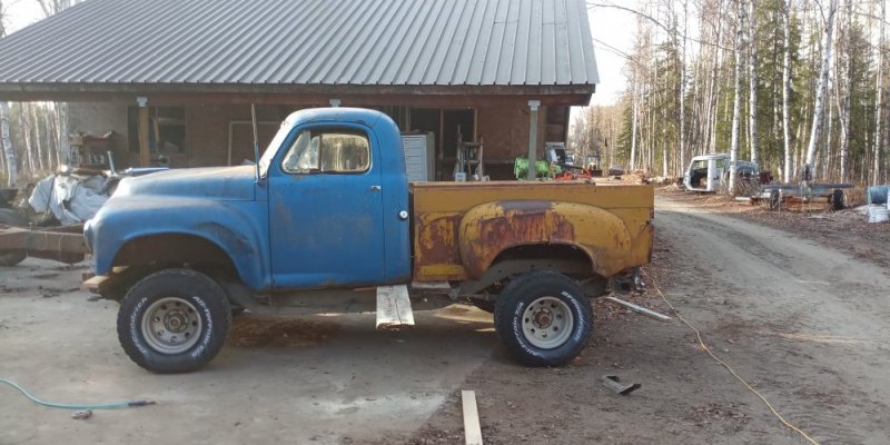

That looks great! Do try to keep front bumper up near grille height above the hooks if at all possible for that amazing approach angle.
The front wheel/ wheel well is perfect. The rear looks good there but could move back a few inches if you want, But adding a gap would be ugly. Only idea I have at this point would be a frame mounted headache (headboard) rack. It being frame mounted would also function as a roll bar and side or rear impact bar protecting the people. Also creates a place for additional lighting. Then a removable rear post assembly for hauling ladders, long lumber, etc. Just an idea mind you- dont think you need to move the bed back- you don’t.
Hows about a rear shot of the frame to bed area? Also, how is the bed floor?
If you can get seat positions in the same adjustment range as gm had them, the airbags could stay and add safety as we know this truck body will not absorb impact as well as the gm body. All the accidents I have seen over the years, and people i know who should have died or had serious injuries if not for airbags - I wish my hummer had them.
