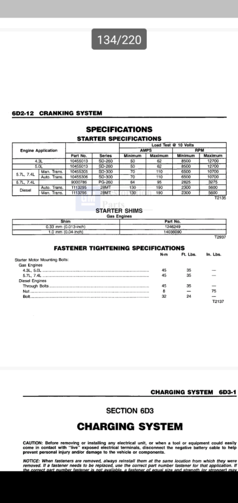

I have the torque spec written down as 35' lbs. Is that correct?
I did a search to double check and found 33, 34, 35, 37 & 40' lbs.

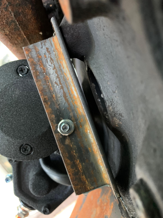

as for the bracket and the rear stud, I had the stud on my old starter break off. when I caught it, I pulled the starter and got the stud out and used a grade 8 bolt as a replacement stud. was this the powermaster starter rear stud that sheared off?
if the block mount point is at any question for cracks, replace that bracket with a longer section of angle iron, match up the holes to drill on the angle with the bracket, but the angle iron longer extending down to just above where the oil pan meets the block. it should rest up against the block there when it's bolted down. if not you can heat and slightly bend the lower end so that it will rest on the block (or lay a weld bead to take up the space) this will provide some extra support for the starter if the block holes are worn or cracked.

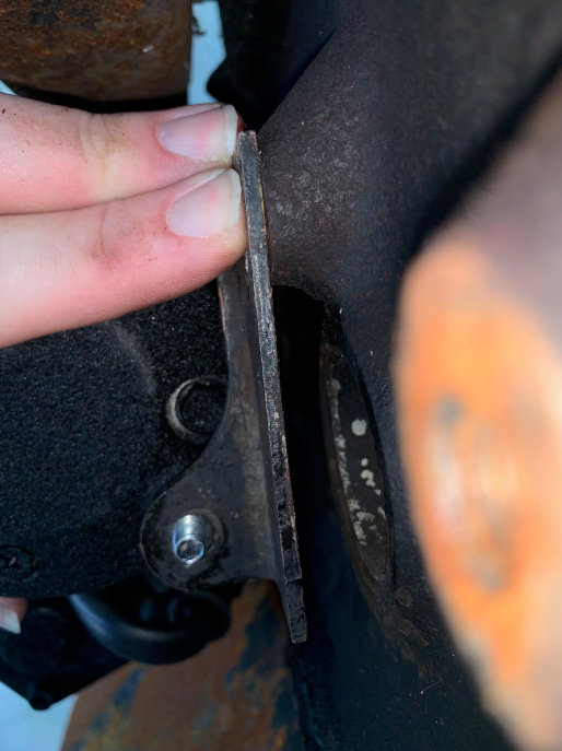

Here is two photos, one of the normal bracket, look at the area where the starter rear stud is and the weak point on the bracket where it bolts to the block, there is no support. Mine bent due to the issues I have with the block.
The second pic is the piece of angle iron I used to re-create the bracket, extending it down to just above the oil pan. much stronger than the factory bracket. This is to help when there are issues with the starter bolts and the block.

Is 35' lbs the proper torque for a 1994?
