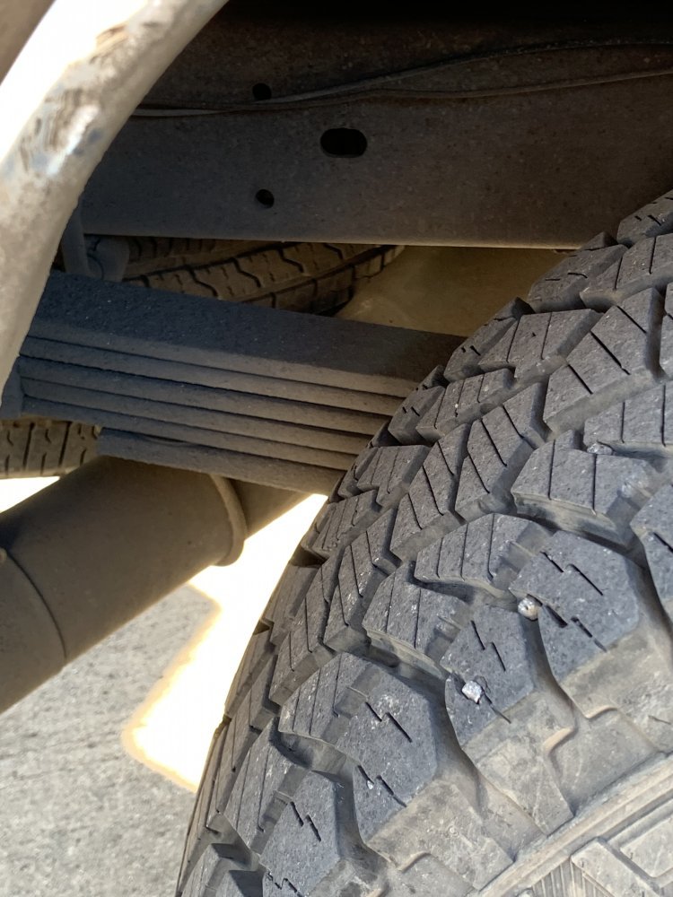

I'm sure mine is squatting some in the rear. how much space is normally between the overload tips and the spring for you guys? for me it's about 3/4 to 1 inch if I inflate the air shocks to around 40 - 60 psi.
That will give me an idea of just how much it's hanging down. the truck does have a slight rake to it with the rear slightly higher than the front, but not much.

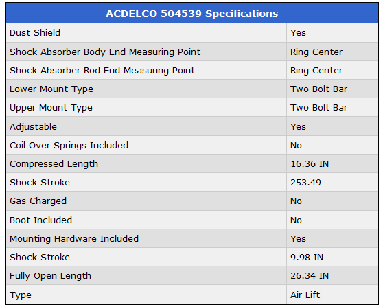

I installed these Delco air shocks in the rear a couple of years ago and I don't know how stiff or light they are.
the shocks can be a contributor to how soft or stiff a ride is. the front are also Gabriel 81668 guardian shocks. I do know that if I attempt to put my weight into the truck trying to push it up and down I can barely move it or bounce it even without air in the rear. and I'm a 200lb guy.

I think before I do anything to the rig, I need to check to see how aggressive these shocks are. I figured I could unbolt the rear ones and try bouncing the truck with my weight along with laying under there trying to compress the shocks and release them. if those are too stiff, I might need to get some other ones. that alone is a simple fix.
Being at the basically center of the truck (in front of bed) might help. I figured putting all the way at the very back of the frame would give the weight some leverage against the suspension. And all reality with these engines an extra four hundred pounds isn't going to make much difference in your fuel mileage I don't think.. but then again my truck has had so many other problems that I don't really know what does and does not affect my fuel mileage it doesn't seem to ever change.
I think i'd get rid of the air shocks and try something else, I have always been fairly impressed with the ride of the gm 1 tons compared to other vehicles.
With the overloads I wouldnt go after an overly stiff shock, something near stock rate, I run bilstein yellows on my 2500, plan to run them on my 3500 as well. currently just have a old set of Gabriels on there.

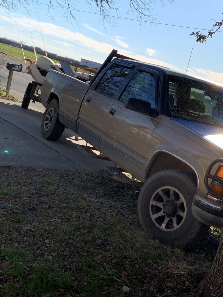

I just pulled a 12 foot trailer today loaded with some furniture my daughter got for her new house, I noticed with just the weight of that trailer on the hitch and with 60psi in the air shocks my truck is sitting nearly level with no rake to it at all. might even be slightly lower in the back.
looks normal to me?
Its not a problem till the spring is laying flat. you still have arch and I bet it isnt close to on the bump stops.
Also, you dont have overload springs, might consider getting a set out of a salvage yard? but honestly If I was you I think I'd get rid of the air shocks and maybe add air bags, or try the roadmaster active suspension.
