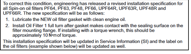

Have you tried torqueing the filter to 45' lbs ?Here we go again. Like it's November or something.

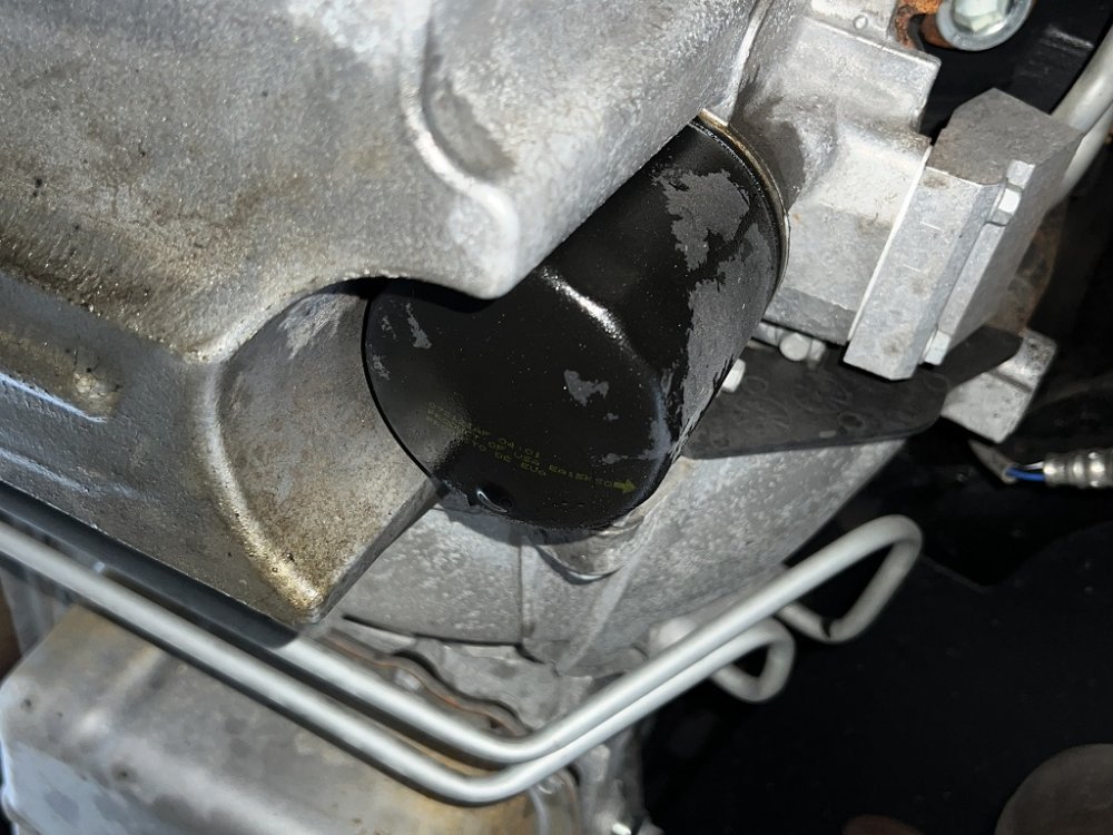

GM Dealer installed AMSOIL filter. Because I handed it to the advisor due to the known AC Delco problem this van had.

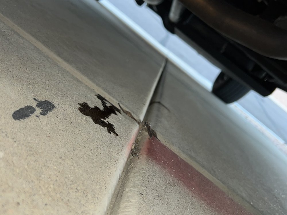

This one almost made it ... 12% oil life remaining.
Go ahead and debate oil and wonder why I ask if your oil filter will go the distance.
(The lighter stain, left, is frame wax that is harder to get off than Diesel oil leaks.)
