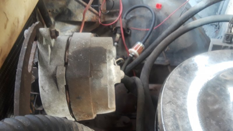

My battery is not charging. Either the rats and squirrels ate some wires or the alternator or regulator took a dump. I know the rodents have been busy. Their little nuggets and stash are on the motor and in the cab. Smells like a nest in there I spent a few months about a year ago shaping, cutting and welding sheet metal to the floor. Still looks new, just smells and looks like the neighborhood critters found a new home. Ehh, here I am rambling again. Sorry bout that. So I need to find the regulator in this thing. It it's in the alternator then I guess that has to be replaced. 20191226_133222[1].jpg20191226_133032[1].jpg
Simple alt setup. Big bolt on battery charge wire on alt should have 12v with key off. Generally has fusible link going to main positive bus bar.
The 2 wire plug is remote voltage sense going to main bus and key on 12v that goes through a charge fail lamp. Usually a battery symbol. Engine off key on do you have a lamp lit like that? Quick and dirty test: Key on engine off both wired pins to alt should have 12v.
If all checks remove alt and have dipstick at store test.
Thank you WarWagon. It was not charging the battery so I replaced it with a reman. Haven't started it to test yet. Had to patch a rust hole in the big fuel tank. It's been one thing after another with this old rusty truck, but I think I'm finally turning the corner with it. Love that JB weld. Hopefully I'll have time Saturday to give it a try.

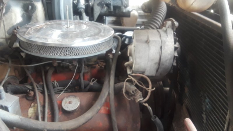

The part circled in red likely used to go to the OEM air cleaner as part of a PCV system. It could use a filter to keep dirt out of the engine. The PCV valve is likely on the other valve cover. Maybe this truck had a road draft tube?
FWIW engines run better on 100 degree F air than 176-210 degree F hot underhood air. Better power and MPG. Thus the OEM air cleaner housing, with it's mile high air filter, and cold air ducts would be a good idea to get from a junkyard. The flipped oem lid or this style air cleaner turns gasoline into noise.
Hmmm,,, That is really good advice I wasn't even asking for. I also thought the air cleaner should have been bigger. I was almost ready to cut that threaded cover rod. Your right about trash getting into the valve cover. That's got to be fixed. I just picked up a Shop Manual Supplement st-331-86s, for the Chevrolet/GM 1986 Medium Duty Truck . I'll look it over and see what can be done to get this motor back in order. It's such a well built old motor, but it does need some minor work. Thanks WarWagon. Much appreciated.
There used to be a tube that hooked from the rocker cover to the air cleaner, with a little filter inside of the air cleaner. That tube can be hooked to the AC by drilling through the base of the AC and then hooking some hose attaching devices to it.
