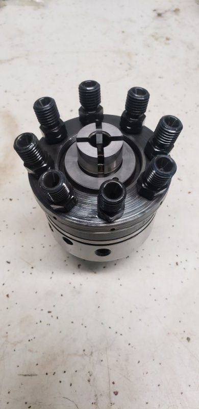

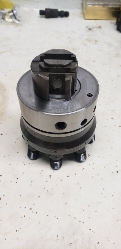

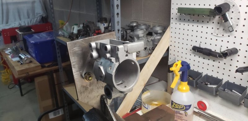

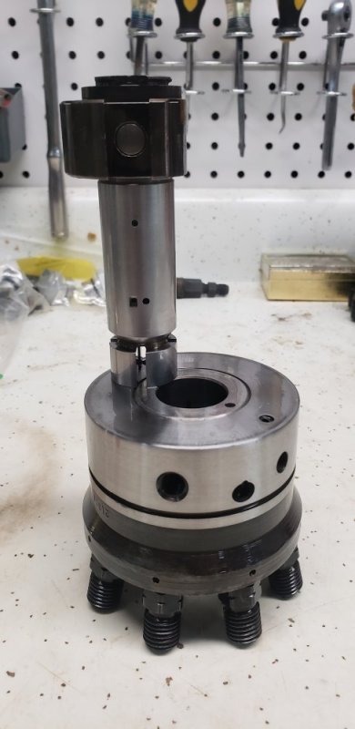

The H&R made it back from the machine shop for Peter's pump. A new undersized sleeve was pressed into the head. Then the rotor diameter is adjusted to fit. This fixes any surface or clearance issues without the use of hard chrome. Then it gets new plungers and the rotor is pressure tested to make sure the delivery valve and plunger don't have to much bleed down. This is the cloeset thing to a NEW H&R you can get but a third of the cost. AND the only way to get .350 or larger plungers in a 8 cylinder pump.

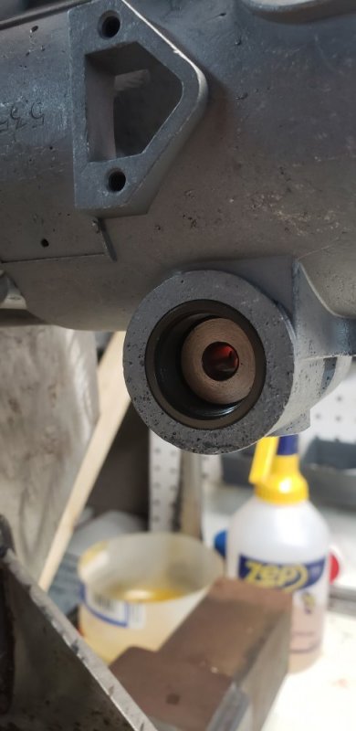

I got Peters reconditioned housing with a sleeved advance piston bore mounted on the vice. I will post updates of this pump as it comes together!!
Thanks for posting the pics and info Sean! Really excited to go full mechanical.
Also the pump is going to have the hypermax puff limiter. Which resolves what to do about the top cover when converting a military 24v pump to 12v

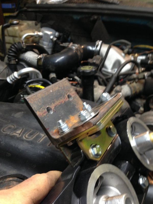

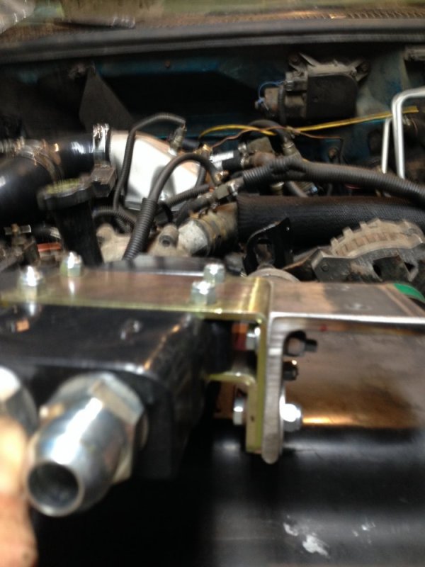

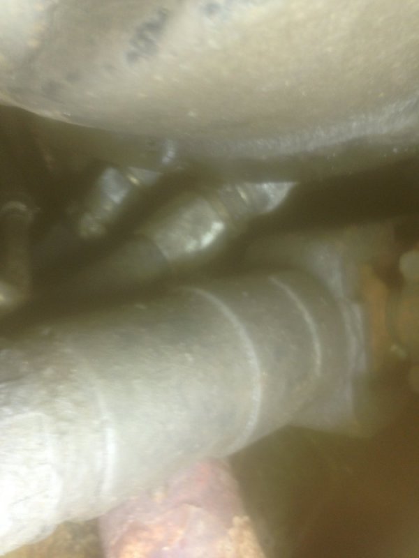

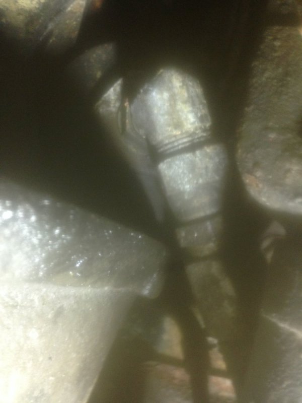

I don't have any pictures of the adapter to the block. If it wasn't in the teens and snowing outside at the moment I'd go roll under the truck and snap a few. Will do so when there's better weather. I made a simple mounting bracket out of angle iron to mount the dual filter base that came with the kit. I ran it on the inside of the frame and the filters sit just above the bottom plane of the frame. Will snap a pic of that was well when weather allows

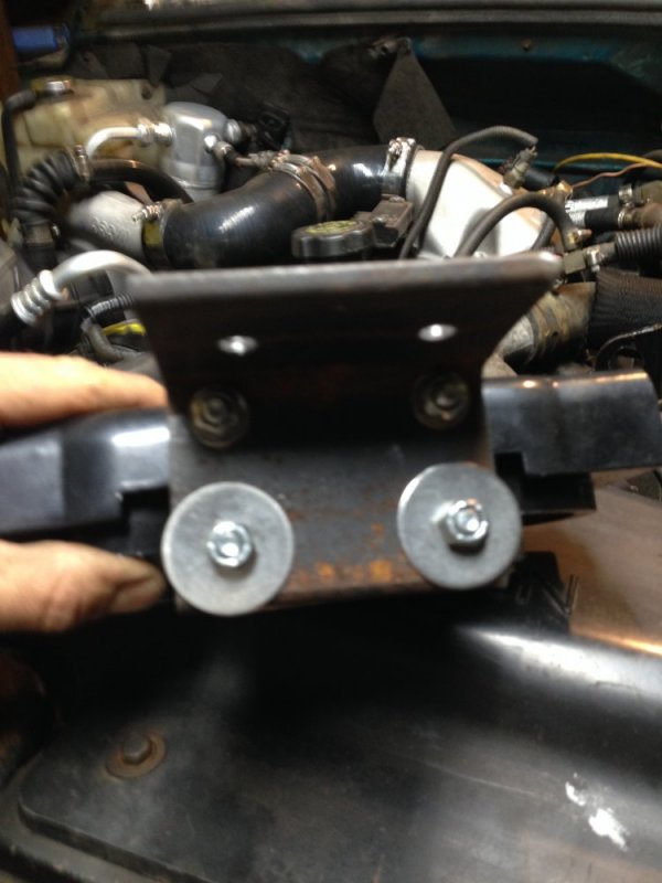

Filter base mounts to inside driver's side of frame just like this. Angle iron sits on top of frame rail

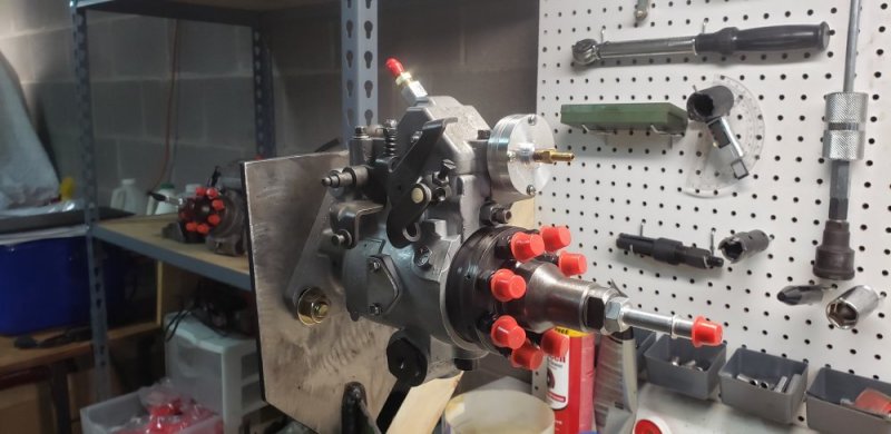

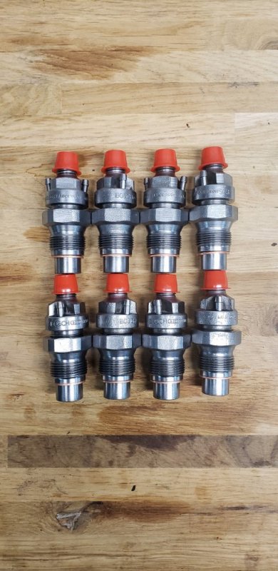

I got Peter's pump and injectors together this week. The injectors are built with stanadyne marine nozzles set to 2250psi. The pump is running the stage 1 fueling upgrade along with the .350 H&R. To limit the smoke on the lower RPMs a hypermax smoke puff limiter was installed. All that's left is to calibrate the pump on the bench. I will post the fuel volume numbers once its finished.

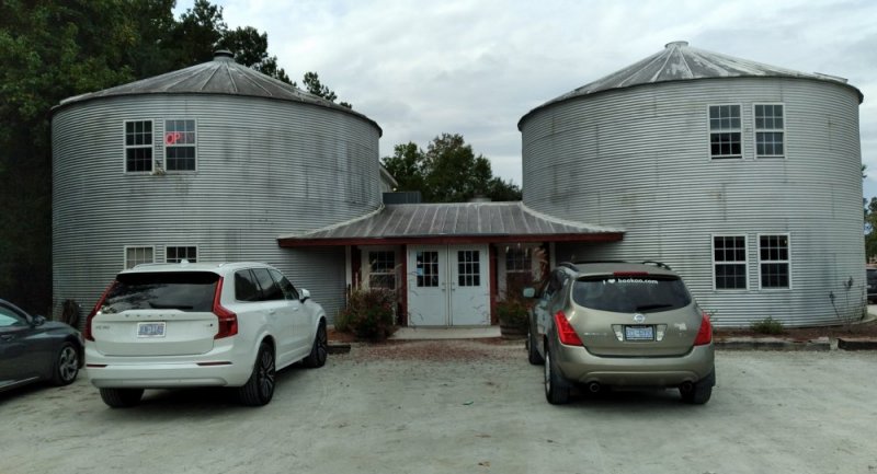

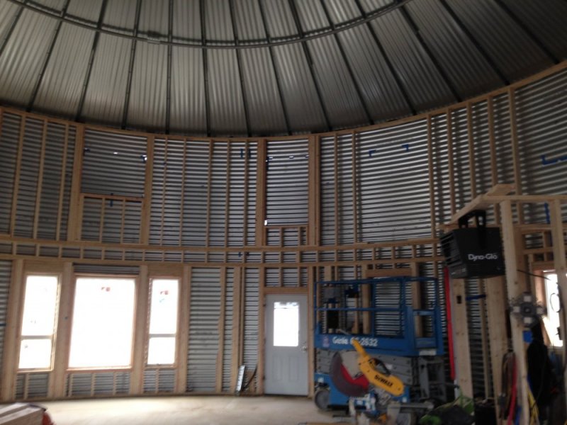

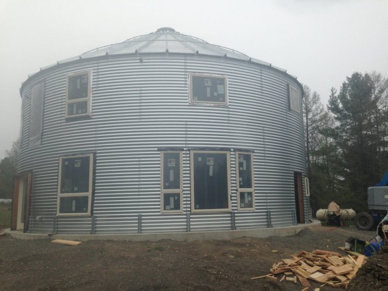

I haven't updated this thread in a while, here's a few pics why. Been working nearly nonstop on a cool construction project taking a brand new steel silo/ grain bin and turning into a home. Job site is an hour away so with a daily commute and working straight through some weekends it seems I'm never home. Project is coming along nicely though!

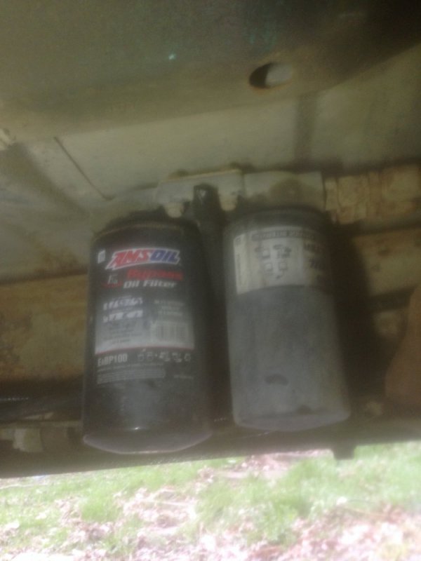

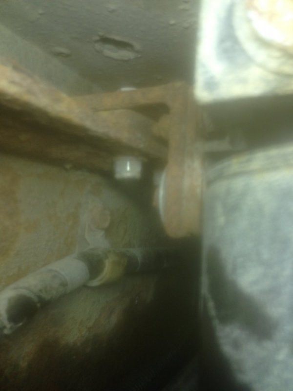

Anywho as promised here's a few pics of the Amsoil remote filter setup on my truck. Clearance is really tight near the front drive shaft and bellhousing, but it fits!
It looks like I put a spacer piece of steel under my bracket to make sure the filters sat above the bottom of the frame

I think you have the old style block adapter, I also had that, they came up with a new style and I now use it, much better fit and much more clearance...
And that house may be a little hard to heat me thinks....
A coat of spray foam on the inside will warm the house up.
It's already airtight. Except for the cut in openings
Very cool @Big Ray! Definitely not the first to build this design, but it really has lots of room for creativity.
There's 4 zones of radiant heat in the floor, along with loops sent through the footer to the front and side entrances to keep entryways from icing up. Plus radiant baseboards in every upstairs room on their own thermostat. 3 inches of spray foam in the walls and 5 inches on the ceiling is all we need to make code. If anything the place may be too tight and some kind of HRV/ air re-circulation system will be needed.
@Twisted Steel Performance good to know about the updated design. If the budget allows every future 6.5 of mine will have the bypass setup
