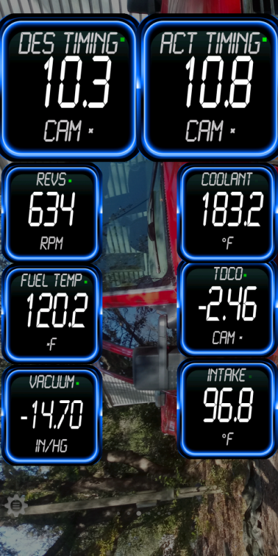

P0251 6.5l please help.
Snap on zeus and matco maximus 2.0 and one on my phone which is where my photos come from i did the koko but i heard its 45 sec pedal down with key on and key off i did 45 sec key on pedal down 30 secs key off and thats how i got my first relearn.
Could a bad ip cause it to not relearn?
generally the IP timing is out of range. I know on the OBD1 system it can get stuck out of range but IIRC it throws a code too. Do you have any codes? Certain codes will keep it from relearning too
with a -2.46 I would try moving the pump to the passenger side quite a bit. IIRC that's the max reading you get no matter how far out it is
