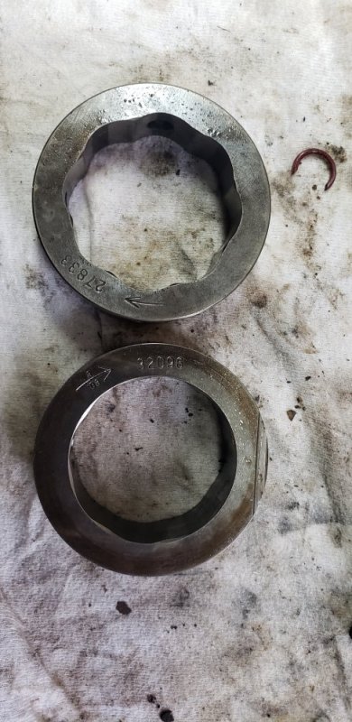

The DS4 only ever cam with one plunger size (.310) like I said the only way to increase fueling is to change the cam ring. The DS4 was available with a few different cam rings and none of which are aggressive enough to cause the pump to prematurely fail. The most aggressive is found in the 6033 pump that was put in the p400. The DB2 had a few different plunger sizes and configurations (.290 .310, .330, 4 plunger. 310) also had a few different cam rings available. The most aggressive are found in the 4911 and 5079 pumps. But I'm not sure why people think these are "unicorn" parts. One call to my stanadyne rep and I can have the parts I need to build a hot DS4 or a 4 plunger DB2. I have the complete parts list ready to go for my 4 plunger build that will be ULSD compliant. I think the reason you dont seen many pumps built with these parts is the cost. Not many are willing to spend over $2000 on a pump for a 6.5.
Oh and if you want to go full potato on a pump build. Certain cam rings can be machined to work in different pumps. That's how guys are getting huge fuel numbers like the pumps R&D builds. But that may lead to shorter life of the pump. I haven't seen feed back on how long the RD4180 is lasting.
Just for comparison. Here is a DS4 cam ring vs a DB2 cam ring. You can clearly see why a DB2 with outflow a DS4. The DS4 may have two more plungers but the DB2 has twice the plunger travel. That is the less aggressive ring out of a 5521s. I dont have any other DS4 cam rings at the moment. But you can see why upgrading to the more aggressive DS4 cam ring is a must if you want more performance.
