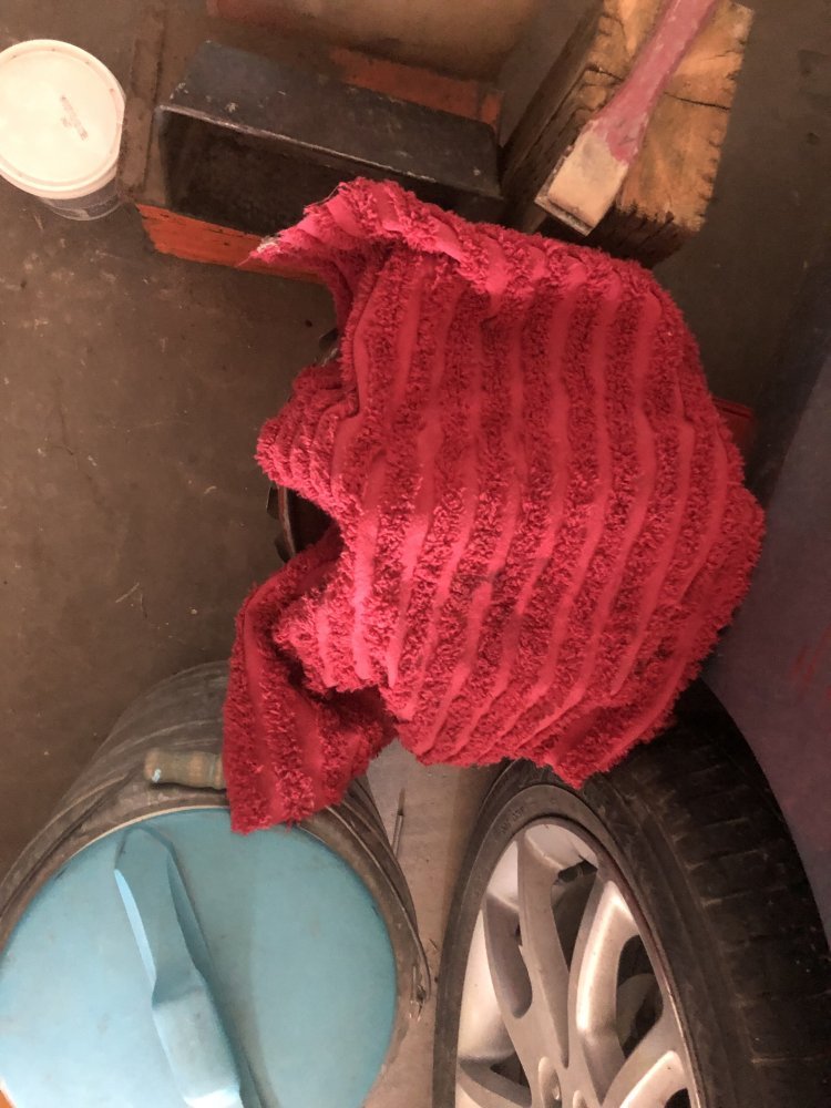

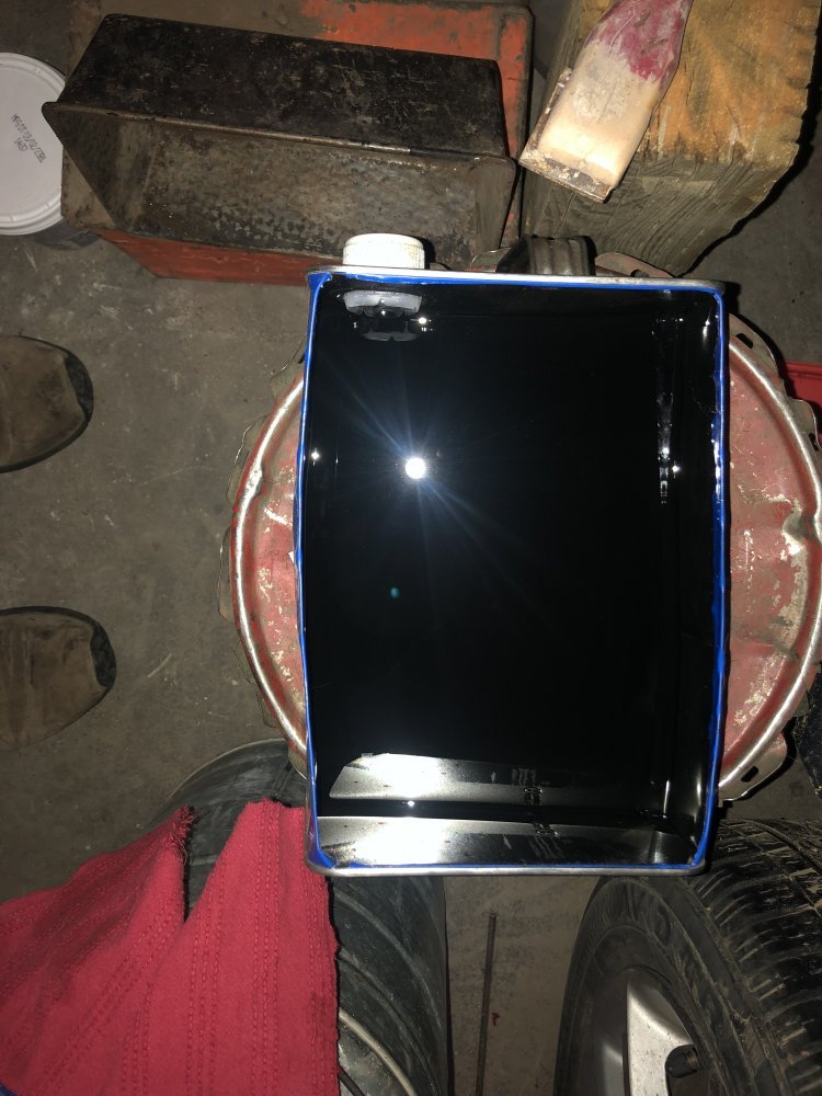

Oh crap.
I think I sent in a sample from the wrong pan.
Moving some stuff around and I discovered this pan, covered with a rag and waiting for some to go for the sample test. I now remember cutting that off the top for that pan and flushing it out thoroughly to make sure there would be no contamination within. Then having to wait a couple weeks to get the sampling bottle and so much going on I forgot about this pan.
And so another oil sample will be going in today. See if the results are the same.
Oh crap.
Bluntly this contaminated and "wrong" oil sample just about sent you down an expensive rabbit hole. Either do the oil samples properly or don't do them at all!
Not sure you have any action needed as the sample contamination from an unknown drain pan used for who knows what before getting dust dropped on it from the air simply ruined the sample.
Start over as you may have many miles left on the engine.
Sample at the drain plug or use a "vampire" to suck a sample out the dipstick tube.
