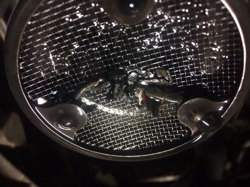

You could also borrow my primer, drain the oil and fill it with diesel fuel and spin the primer and turn the motor by hand or with the starter ( after removing the glows to let the combustion psi out) to maybe flush something out... could you have something in the pan that is getting sucked up against the pump screen???
