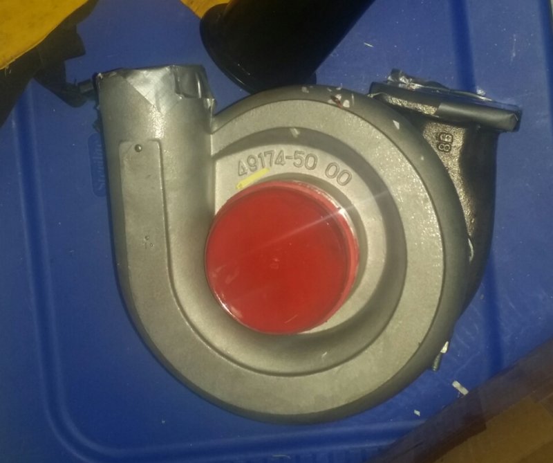

Now the fun begins
I cant wait to get it installed my chip should be here by Saturday, I don't have but 2 pounds of boost so the new turbo should wake up the old girl, I think I have a bad wastegate or Vacume pump
The old turbo is off

When doing the final install of the silicon hose and adding the clamps in the middle, consider trimming either the leading or trailing end of the silicon hose by a bit (in the neighborhood of an inch) and the compressor will then rotate where it is not pointing 'up'. Result is a cleaner look and shorter path for the air.
