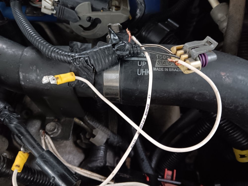

Ok..update..worked half the day, cane home had an idea. There are 3 wires to BARO sensor..found what I think is the 5 voltage hot, and the ground, and I spliced a long piece of wire into the 3rd wire "redish color" and put a toggle switch on that wire to cut the signal, or so I thought. Plugged it back up, switch was on, so it was normal. Went for a spin..boost gauge on monitor worked, and the baro sensor worked as well...but, it again, at not even a quarter throttle, was demanding 19k to 21k rail pressure, gagged on it, and poof, limp mode, threw the P0093 code....reset everything, turned the switch off, but, both gauges still worked lol..went for another spin, finally, the desired rail pressure was matching my placement on the throttle! 5k, 10k, 15k, 18 then 21.5 to 22k at WOT. NO CODES, BOTH GAUGES STILL WORKED CORRECTLY, TRUCK RAN LIKE A STRIPPED APE....I'm stumped lol. Just PLUM stumped. But, it's a good thing I reckon. I can haul my equipment now without reseting codes every 30 seconds lol. No smoke, haze, bad sounds etc, and much lower EGT...go figure lol.

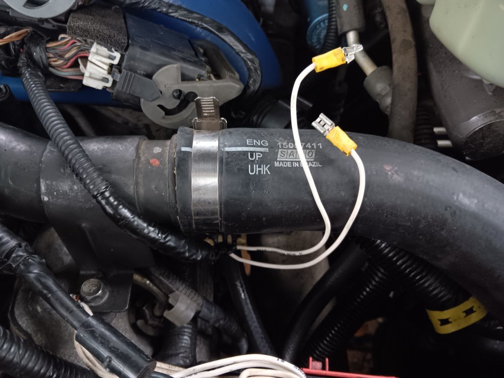

Ok. I indone my previous work to show what wires, color etc. Switch broke also while disassembly lol, so I'm using connectors till I get another. Anyway, I just spliced that wire, made it longer where the sensor could stay plugged in, and I had the ability to break the circuit of that wire only. When it is not plugged, truck runs like a new one. When plugged in, as in "normal" is when it throws the P0093 code and demands too much rail pressure, too soon. Go figure lol.

Yeah I think that's the +5v feed line you spliced into. maybe this is that programming issue they were talking about with the ECM?

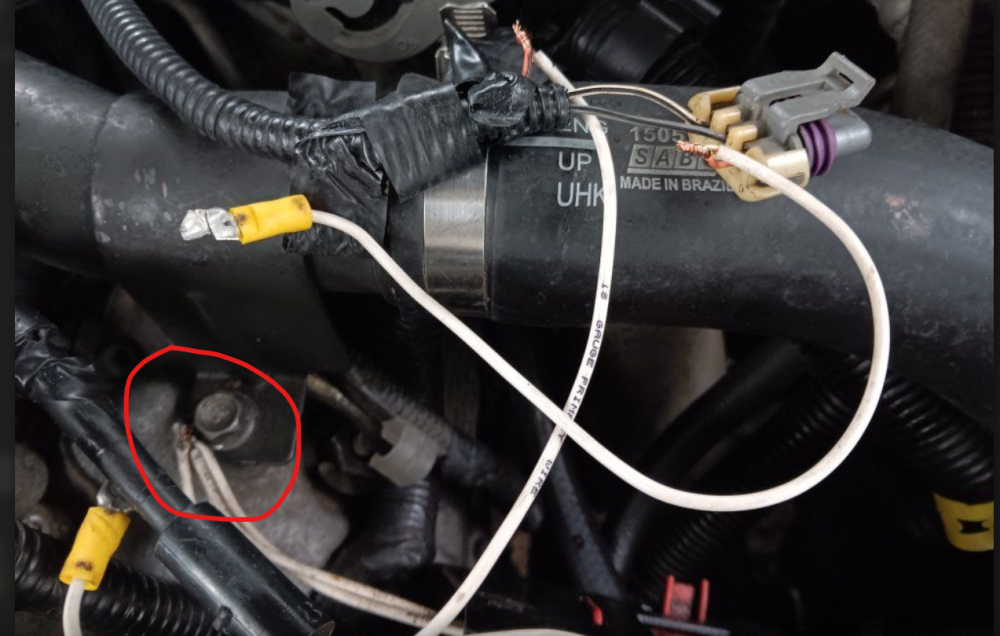

I noticed what looks like some ground leads with wires bare smashed under a bolt. what is that in the pic I circled?
That is a spare "ground cable" I ran from battery to engine couple months ago when I started chasing this issue lol. I tried everything lol

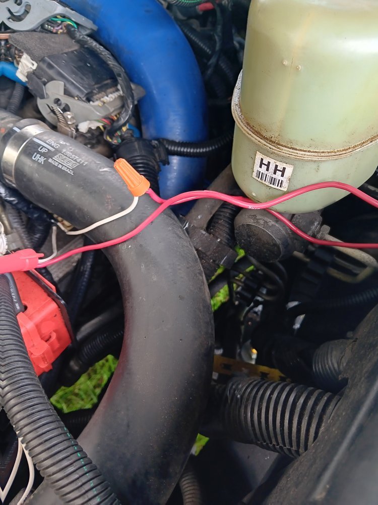

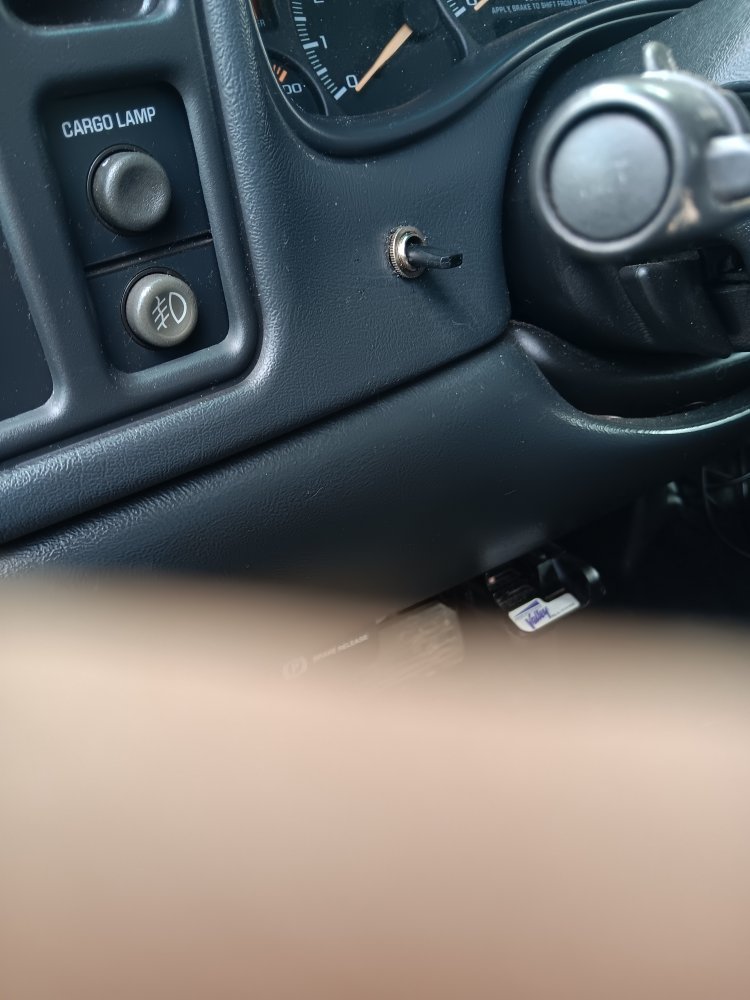

Update. I put this wire on a switch on the dash where I can switch it on, in normal mode, I'd somthimg was to go wonky. But I run it with the switch off, with the circuit of that one wire disconnected. Baro sensor still reads, 13.8 to 14, and boost signal still works. With it off, the desired rail pressure now comes up gradually as I get into the throttle, instead of demanding 20 to 21k at only quarter throttle. Blows my mind, how and why this "fixed" it, but considering all I been thru last 8 weeks, I'll take it! Lol. Trucks runs great. It isn't de fueling, no codes, no lights etc. I appreciate all yalls help also. Much respect.
