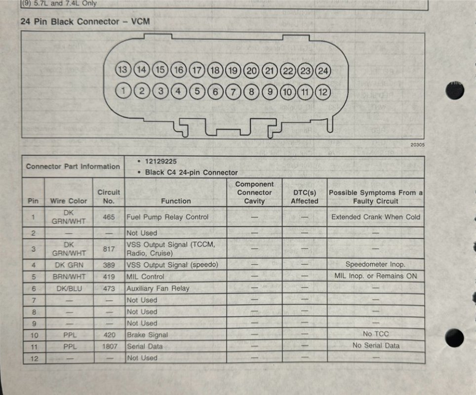

Last question towards pavaltolz, how would I specifically check the connectivity between port 2 and ecm?
Sorry for the delayed response (Anniversary Celebrations and all).
I had to do a little digging in the 1997 manuals and (for us diesel guys) where you have a Vehicle Control Module (VCM) near the Brake Controller and the Under Hood Fuse Box vs. my 6.5. ECM next to the Glove box...my learning curve, no condescension.
Probe for continuity between the Data Link Connector's Pin 2 and the VCM's black connector, pin 11.
I'll search the other books for info. Here's the Schematic in the meantime.

Shop looked over everything ended up getting communication with ABS but nothing from the transmission or engine. He ended up telling me to take it to the dealer to have them reflash the ECM. He's never seen it where it will communicate with the ABS but not the ECM. Will know Tuesday if the reflash fixes the issue. Tried to reset ECM by unplugging negative terminal to battery and jumping positive in battery to disconnected negative terminal but all i got out of that was my radio no longer works.

Well Doug I didnt see this comment in time, dealer mentioned something about a recall I believe. But yeah after diagnoses they told me the entire ECM was bad and they went ahead and ordered a brand new one from GM down in Arkansas. Will have it here Friday and they are gunna put it in Monday morning. I believe the dealer had a diagnostic fee of 300$ and the part was 391$ after the 79$ core charge. They said 168$ to put it in so somehwere around 800$ just to get communication back so I can see whats going on with the transmission. I thought I read that a bad ECM can send bad signals and cause issues with overdrive / transmission in general but im not sure.
Yeeouch!! That's gotta hurt the pocket book. I do hope they guarantee that if this doesn't fix the problem, your not out the cost of the new ECM and some credit for a mis-diagnosis. Hopefully the tech working on your truck back probed each and every pin to the ECM verifying there is no possible issue before ruling a bad ECM, at least for a $300 diag fee.
