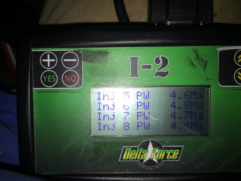

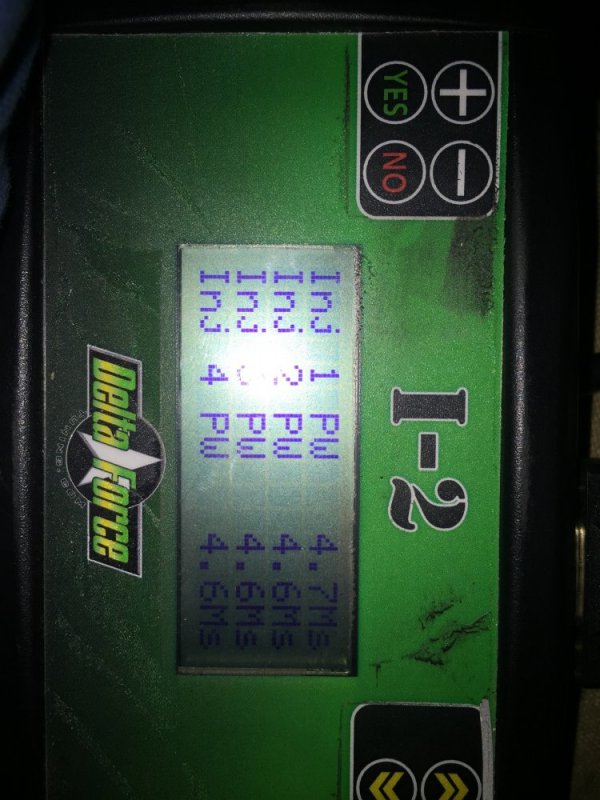

I don’t know if this will help any but this is what my tuner is reading the injectors at. They all are very close just fluctuate a couple decimals. None of the wires have any chaffing from the FICM bracket. I ohmed all 8 injectors at the plug on top and they all ohmed out the same. (Snap On ohm meter). I’m at a complete loss. It ran like new all day until this evening it jacked up again. All I did was pull the valve cover, check to make sure the wires were hooked up, and put everything back together. This morning I put it back together and hooked the batteries back up and she ran perfect. CE29B155-692E-4709-BFCF-DDC2CF424CB9.jpeg7F6DFDBD-2343-43A7-B9B2-5B8595606351.jpeg
