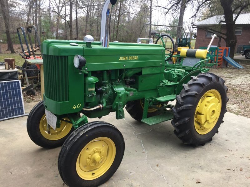

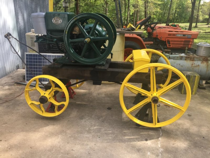

Buster, that is some SERIOUSLY nice hit and miss equipment and the WF 40 Deere is a beauty.
